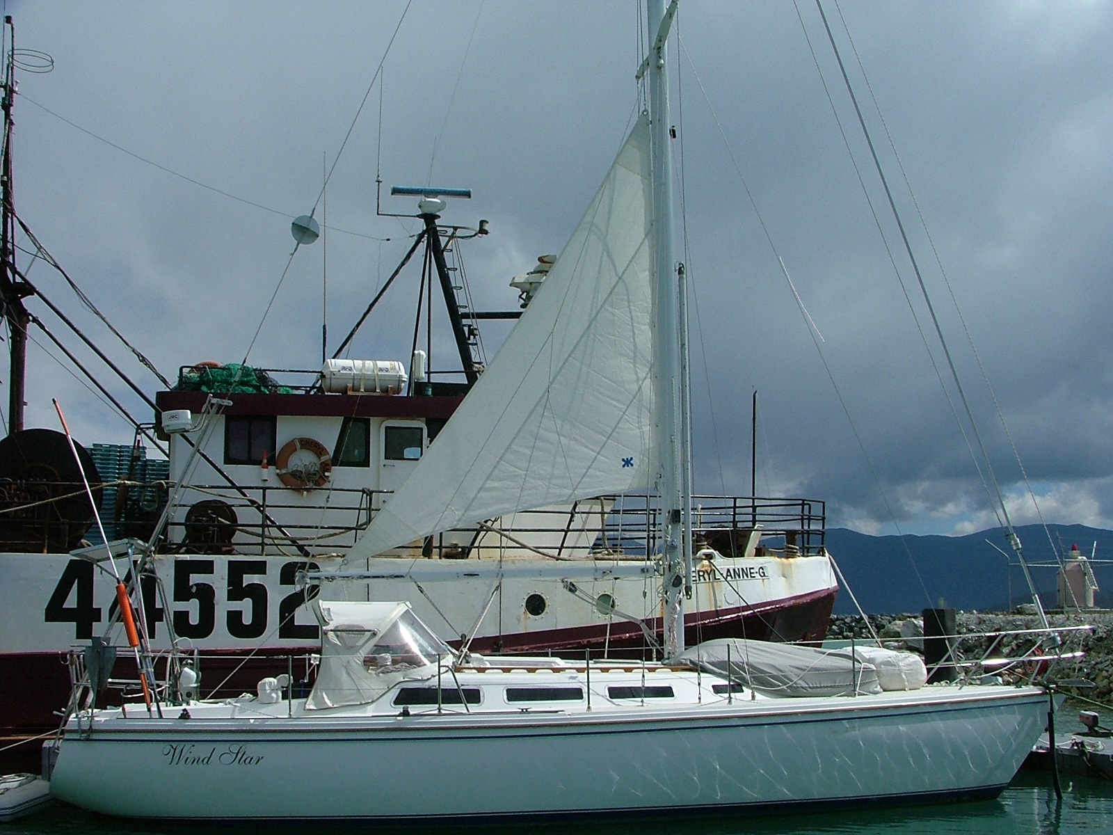

We have a removable inner forestay, from just above the spreaders to just behind the anchor well.
There is a chainplate bolted to the aft bulkhead of the anchor well with a Hyfield lever ready to connect to the inner forestay (see photo)
We have a hank on staysail for beating in stronger breezes, and a storm jib after that.
Because the inner is adjacent to the lower shrouds, we don't use running backstays.   I have noticed a little 'pumping' of the mast when on staysail.
When not used I wrap the inner around a lower forward shroud and bungee down.
Hope that helps :-)
