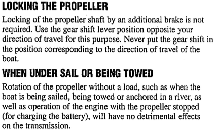

From the Universal M35B manual on gear selection when not under power
Greg
ROAM
C36 MkII 2001
SF Bay
