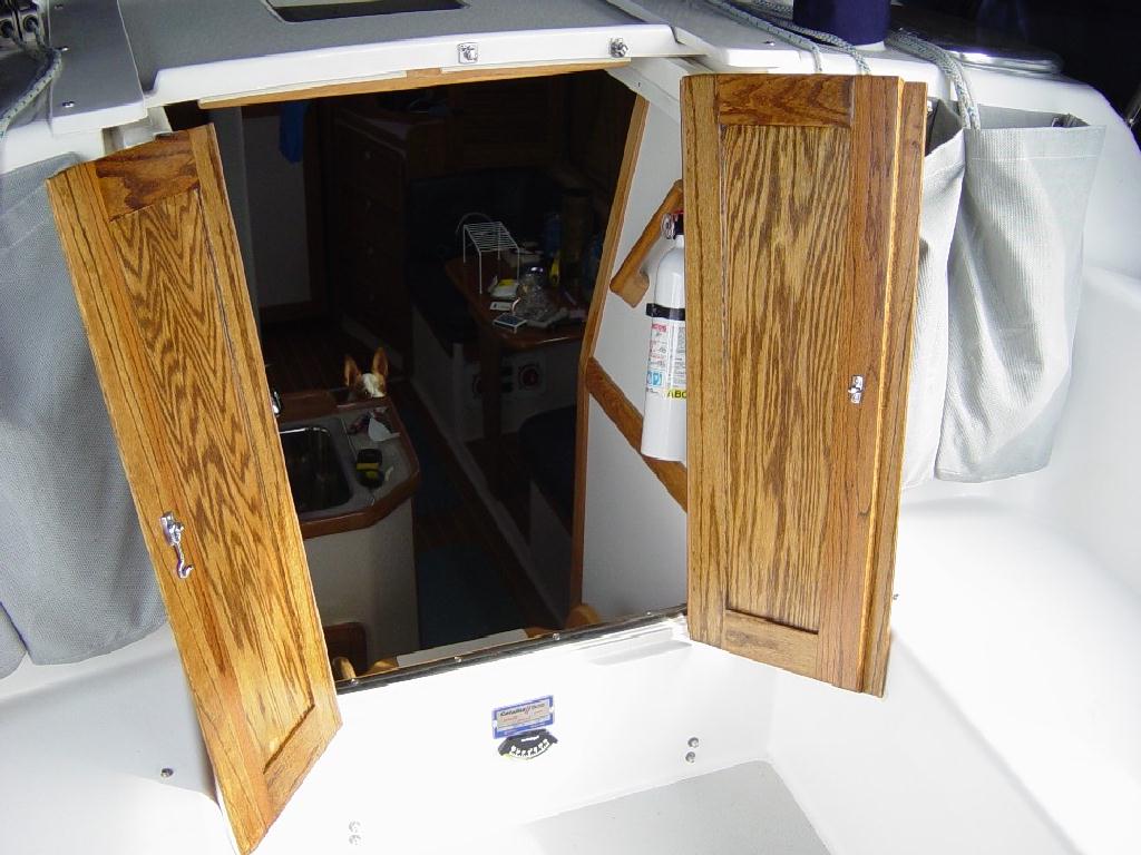

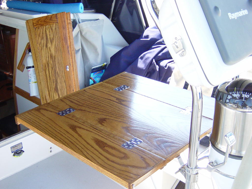

If you are handy with woodworking or know someone that is, try making your own. I took the challenge several years back and they came out pretty good and have been happy with them. They make it very convenient to go in and out and keep the elements and other such things out of the cabin. The ones I built have lift off hinges in the event I want out of the way.
Total cost of all materials was under $100 for the doors. The folding cockpit table cost a little more to make as I purchased the hardware from Edson.
