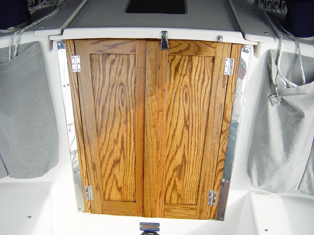

If you are semi handy and have a little more than basic tools, you could attempt to buil your own. I made mine for under $100.

We built ours with a table saw, and a planner (get wood to fit to hatch board slides, the only big expense was the plastic (LEXAN). I've built at least 4 set for other boats in our marina (only 12 S/V and 300SP). The hinges are plastic seperating hinges from W/M. The 3 pieces of wood interlock with each other and have to be "worked out". I would post pictures of them but I am not a computer wiz, I've tried for 30 min now-sorry

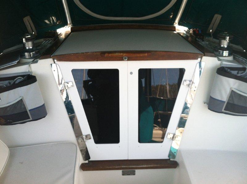

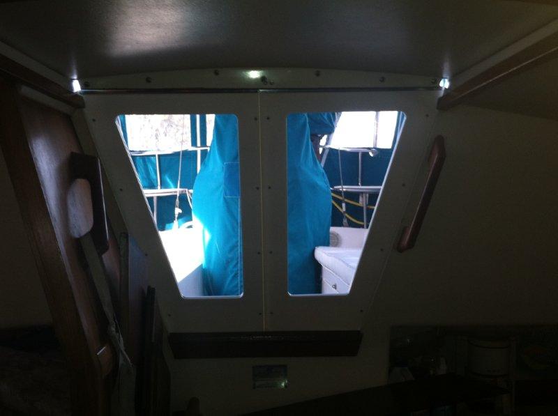

Just finished the install including replacing wood side rails with SS. Really makes the boat look good!
Stephen Noe
S/V Earendil, Oriental NC, USA
1985 Endeavour 42
Very nice!!
