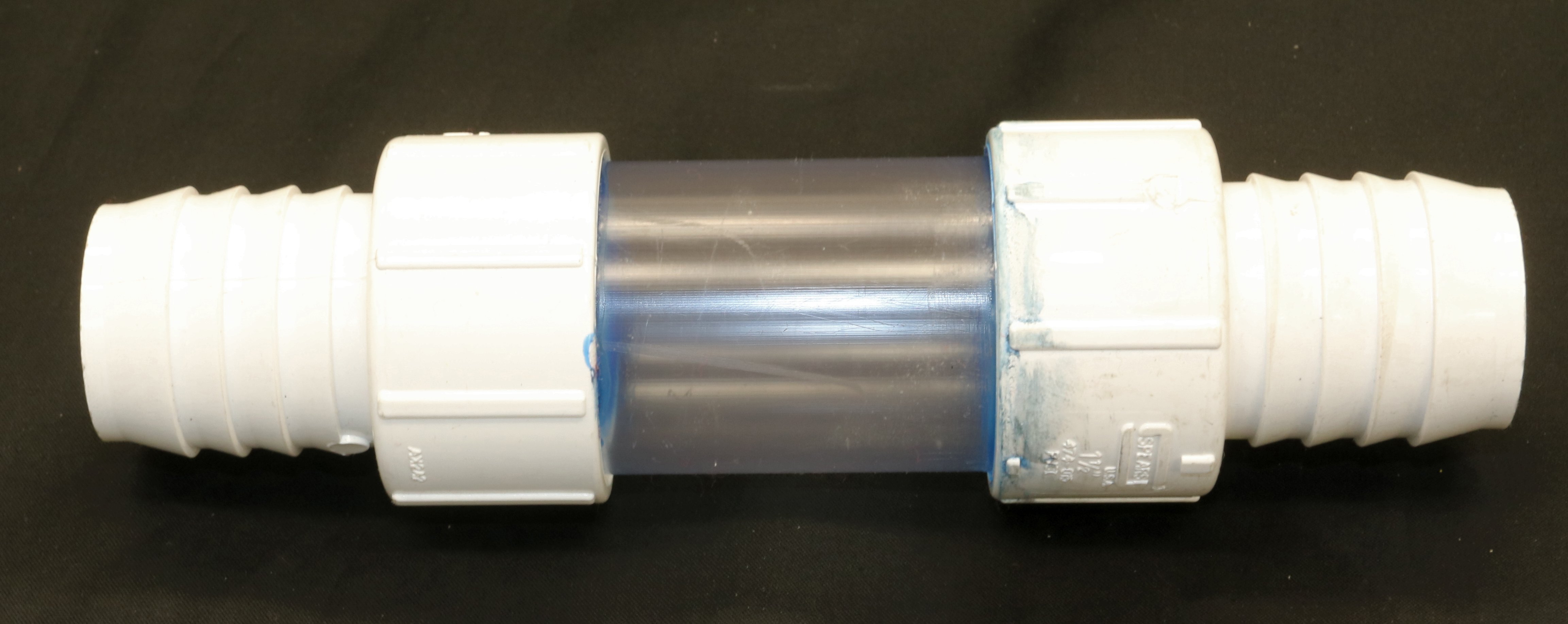

Clear pipe in head hose between tank and macerator
Hello 36'ers
It was great to talk other 36 owners at the recent Catalina Rondevous at Two Harbors on Catalina Island.
I read somewhere in a thread about a clear pipe insert to observe the outflow from the holding tank. I liked the idea so I decided to make a fitting and share it with my fellow owners. one foot of clear 1.5 inch PVC and two fitting plus the clue cost about 16 bux. time assemble 15 mins including coffee break.
Now I wont have to guess based on the sound of the macerator whether the tank  is empty or not.

Capt. Bill - interesting idea. Can I get a photo of the completed installation?
