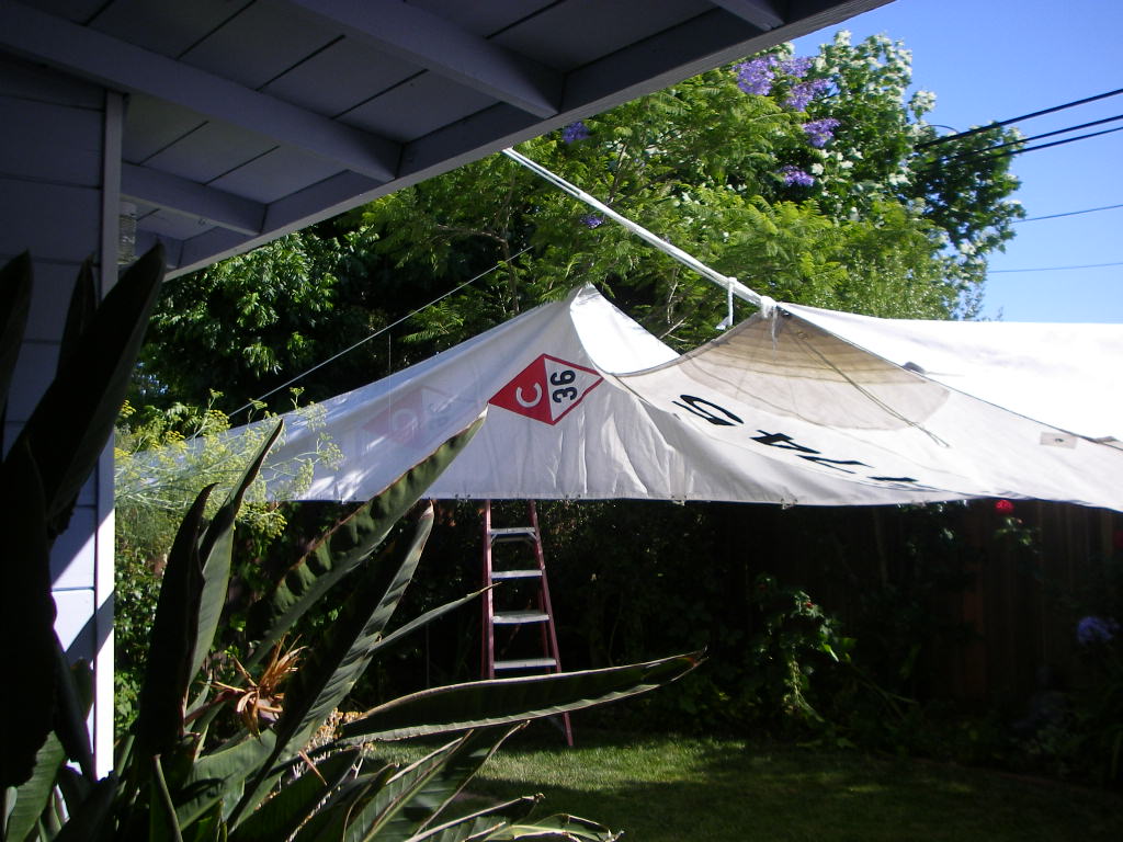

What I did was to lay drop cloths on my patio, then placed the mainsail accordion-style on that. Avoided grass due to possible green stains.
One section at a time I gently scrubbed the sailcloth with dilute oxyclean in warm water, taking care not to abrade while working out most of the dirt.
Oxyclean does a quick number on any black mildew spots (oxyclean contains a stable form of hydrogen peroxide).
I also used Oxalic Acid (USP powder dissolved in water) to take care of the rust spots.
This from Wikipedia:
[I]Oxalic acid's main applications include cleaning or bleaching, especially for the removal of rust (iron complexing agent), e.g. Bar Keepers Friend is an example of a household cleaner containing oxalic acid. Its utility in a rust removal agents is due to its forming a stable, water soluble salt with ferric iron, ferrioxalate ion.[/I]

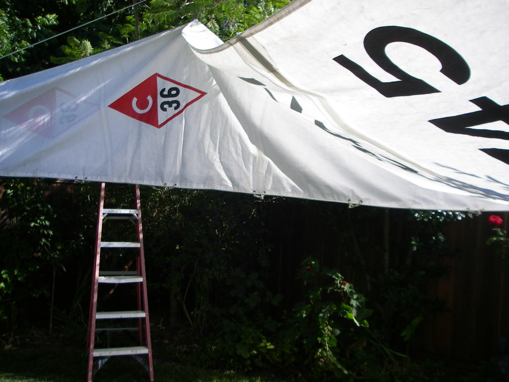

After rinsing well with fresh water, I hung the mainsail to dry in the backyard.
It was summertime, so it made a great shade cover for the yard!
