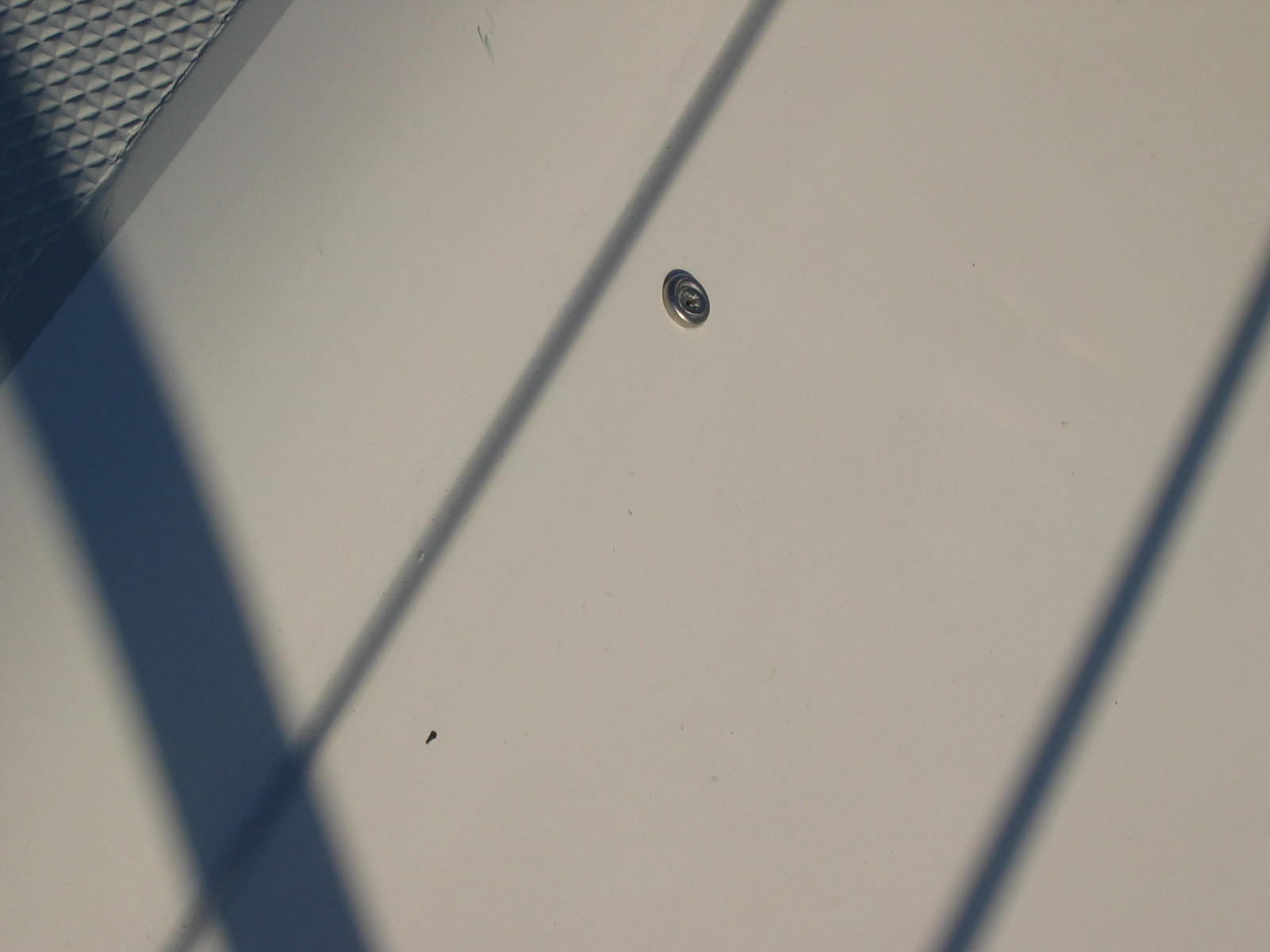

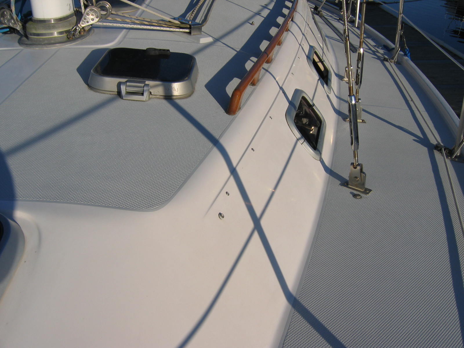

Attached are a few photos showing the boat with the screws and washers installed. The screws and finish washers are #4 size. West Marine had the screws in stock, but had to order the finish washers. There are a lot of them, so bring your cordless drill with a bit. I put some silicone sealant on each screw.
Overall, from 15 feet, you can hardly see them. Up close, they look good, and almost like they belong there. It makes polishing that area of the coach roof very easy. I'd recommend this fix.
--Nelson Lee

Thanks for the pics Nelson, and thanks to Catalina for spacing the original screws so nicely.:) This looks pretty good.
