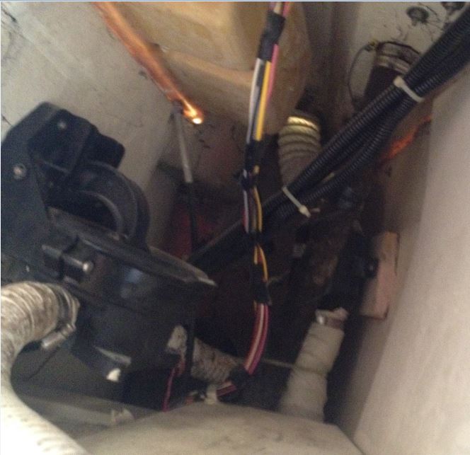

I was cleaning out my cockpit locker and confirmed the blower location. Best access looks to be through the engine instrument mounting hole but may be reached by a very skinny person via locker. Pic shows inside of port side locker facing aft. Kind of blurry but blower can be seen aft and below of instrument panel mounted on wood block on hull.

Gary,
Thanks for the picture and finding the exact location of the bilge blower.  I'll need to recruit my skinny nephew, he loves challenges like this.

Sorry to keep you all waiting on my results of the Bilge Blower Location/Replacement.  Here's how It was replaced on Calypso:
I cleaned out the port cockpit locker as mentioned above in a post, laid a towel down on the base of the locker and slid in.
The replacement was relatively easy requiring the removal of 2 screws securing the old blower to a wood mount. Removing the intake & exhaust hose as well as the 12 VDC wires.
Make sure you install the new blower in the correct direction (there is an arrow on the side for air flow)Before securing the wires verify proper polarity to the DC blower via air exhausting out the bilge vent.
With a cleaned out locker this is a 15-30 minute project.
