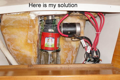

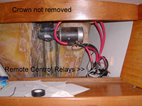

Posts: 468
I have been reading the posts about the V-berth water leak and I have solved my problem - see 3 images below.
  1.  The panel can be removed without removing any of the molding
  2. I located the leak and it was from the shaft seal of the windlass - but I was unable to remove the frozen shaft.
  3. The solution - a funnel - no more water
  4. On the right side you see the remote control relays that I have added to operate up and down using a switch box while at the helm.

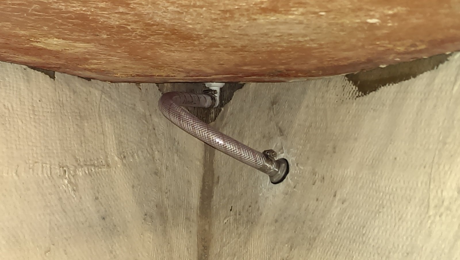

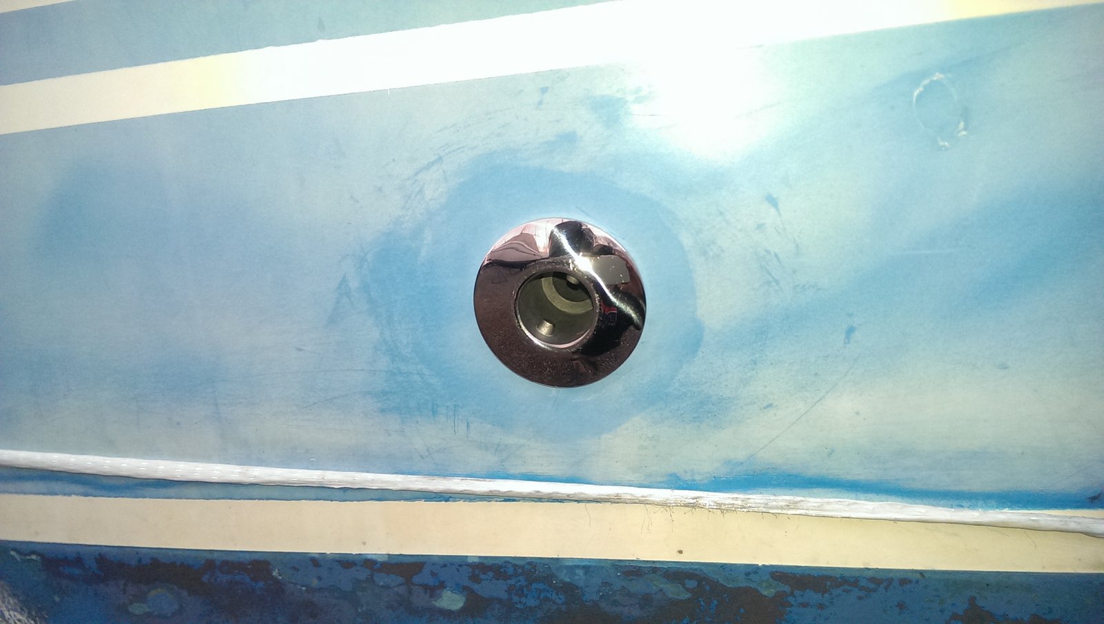

llunved
Joined: 5/22/14
Posts: 20
My original temp-fix with lifecaulk did not work. But I hope I got my problem under control after spring work: two coats of Gluvit to fill the cracks from inside the locker and from the v-berth side of the bulkhead. Then a layer of west system with adhesive filler to cover the seam and provide a smooth surface. On top of that spray-on truck bed liner.
I'll share if it worked.
1988 Catalina 36 MK I - Swept Away
kevin_j
Joined: 6/27/14
Posts: 5
Loving that through hull! Looks like someone glass the aft facing bulkhead in your locker too. Is that done at the factory or PO I wonder.....
