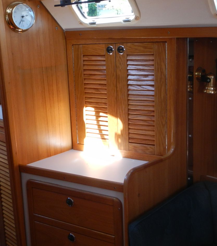

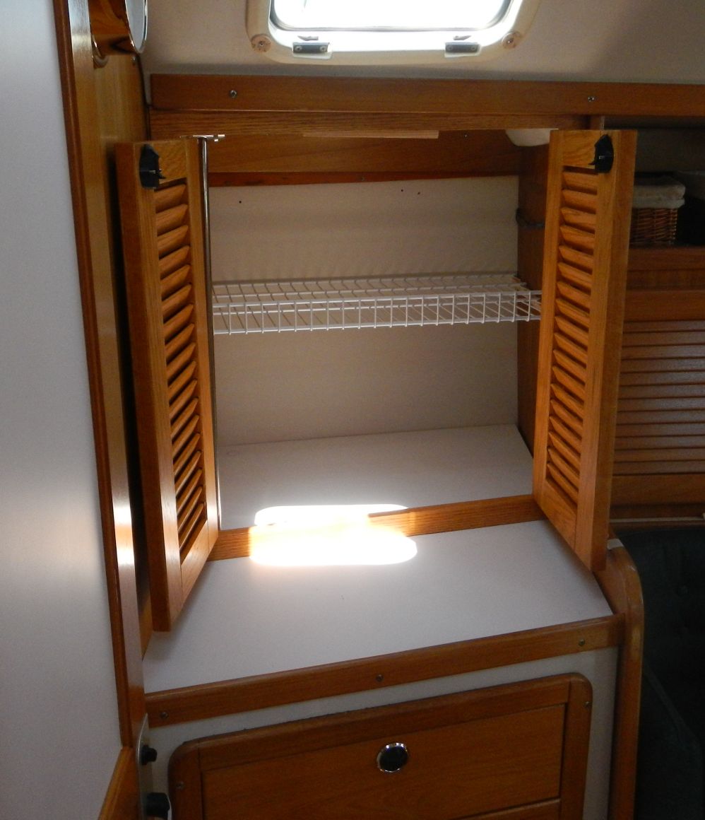

I got rid of the piece of crap all together. The big project was making the jig to make the louvered doors.

Very nicely done Nile and much better use of space
