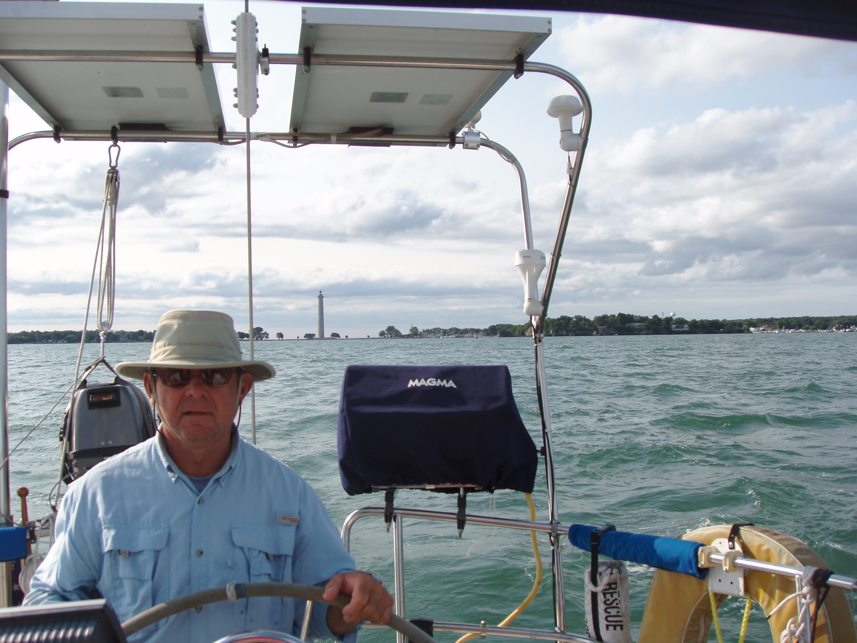

Blake, maybe not the best picture of me or the grill.  Notice the yellow hose going to the grill, it is a flrxible metal hose for natural gas, the end fittings are attached to the hose it self.

Thanks, Lou. Looks like a nice set up. Most of the connections I'm finding for CNG have that same corrugated yellow hose.
