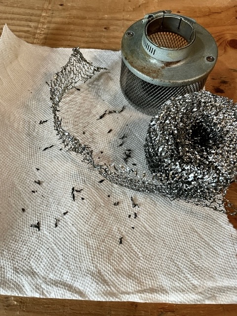

I went to replace the external foam filter media on our M35B and spotted some "shiny flakes of metal" inside the wire mesh air filter housing. I removed the air filter assembly from the engine and discovered  that the aluminum mesh core was disintegrating. It contained numerous small fragments as can be seen in the photo. I believe the wire screen at the base of the filter body prevented any from being sucked into the engine (hopefully, as the engine seems to run fine).
I was aware the foam has a tendency to breakdown, but not aware that the aluminum mesh core also has a finite life.
I have a new air filter assembly on order from CD.

Suggestion,
Replace with a K&N filter, I.e. RU 0260. Just a thought.

Thanks. The K&N RU-0260 seems like a good alternative, but availability appears to be an issue.

Auto zone auto parts has them in stock.  $55?
https://www.autozone.com/intake-system/custom-air-filter/p/k-n-ru-0260-s...

Odd. The local Advanced Auto Parts couldn't locate any in their system.

I agree Paul.  My local store came up with a KN 2600.  I've ordered one, if it doesn't fit, I'll take it back for refund.  My follow up will be late July 2023.  Stay tuned...

There appears to be plenty room for an elongated air filter on the side of our M35B engine, so that expands the options as long as the new filter base matches the diameter of the filter mount on the intake manifold..
That said, I ordered a new filter from CD last week so I'll stick with the OEM replacement approach, which lasted for 17 years. I noticed the aluminum mesh core creates virtually zero resistance to airflow. Unlike an automobile air filter that is designed for fine sand, road dust and dirt, I think the Universal Engine OEM filter is designed for blocking larger contaminants, but wouldn't fair well in an automobile.
