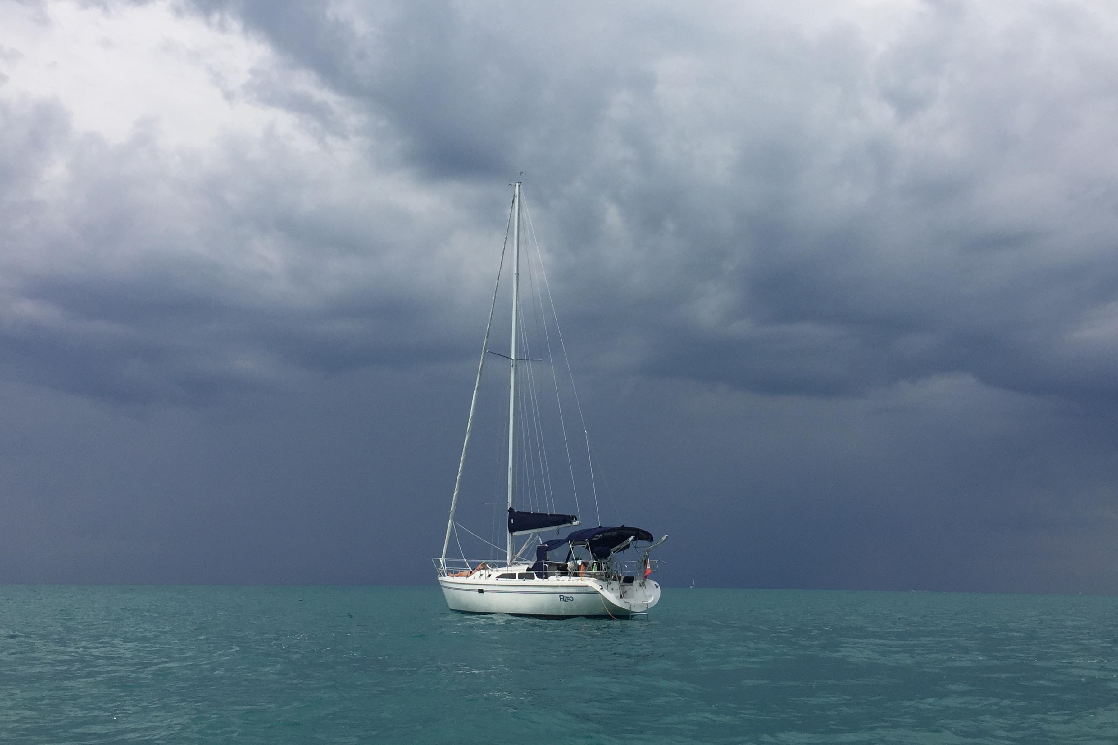

I was looking at selling my 36 MK 2 and moving to a 400 or 42. The cost was getting up there so also looked at the 380. My 36 is very vell equiped with new sails, upholstery, davits, cockpit cushions plus full enclosuer. My wife, the sensible one, said why not just keep the 36 and spend a few more dollars on creature comforts. We would like to take our boat from Lake Huron through the Erie Barge Canal then spend a summer on the east coast, Annapolis to Cape Cod. I hope the boat is a decent size for this. (I need convincing)

Hey Rich, first of all that's a great picture of your boat!  I am under agreement for a 1999 C36 MKII, I take delivery in May after the surveys are complete.  Since I am new to Catalina and have never owned a boat this size before I can't speak with authority, but just a couple thoughts...
