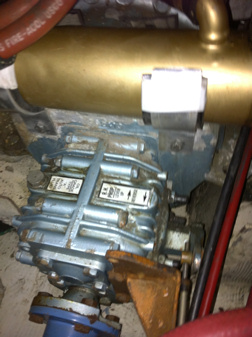

Interesting, last fall I decided to take my HE out basically because I had some overheating issues and the age of the boat I felt that it was time to have the HE serviced. After removing it I put it in the basement and brought it to the radiator repair shop in the spring. The shop called me and told me the two brackets were missing. I guess because I am getting older and forgetful I assumed they were on the boat and I just unbolted them. Well long story short they must of been brazed and had seperated. I could not find the bolts or the brackets anywhere.
I ended up fabricating new ones from aluminum scrap at the boat yard. Approximately1//8th thick by 2" wide and about 6" long. Made a distinct 90 degree bend (approx 11/2" and shaped the rest to the diameter of the HE. I used 1/4" thick rubber and taped to the bracket and used two other strips to go in the saddle shaped by the bell housing on the back of the engine and bolted it in place.
This turned out to be a very solid holding solution in that there is really no vibration. I believe the rubber has somewhat isolated the HE and thus has done away with another item that contributes to the noise level of the engine. The yard owner is a little skeptical of the aluminum and vibration but as I mentioned this appears to be quite solid....we will see what happens over the summer.

Note this is not a great picture but a simple fix as in initial thread brackets that were missing and originally brazed to HE replaced with scrap aluminum and 1/4" rubber appars to be very solid fix.
