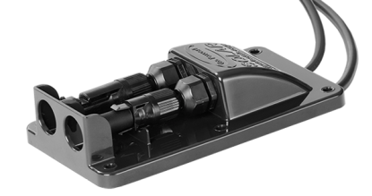

Hi everyone, I recently bought a 2001 C36 mkii and since I'm on a mooring I'm looking to install a solar panel to help keep the batteries topped up.
I've read Maine Sail's articles and noted the Scanstrut deck gland recommendation.  But I would really like to be able to remove the solar panel and the wiring when not in use (heavy seas, winter storage, etc).  I tried to look for an MC4 "outlet" deck plate instead, and came across the Go Power model GP-CEP Cable Entry Plate.  It has 6 screw mounts and I was planning to seal with 3M 5200.
Has anyone come across this entry plate, or had experience with other deck-mounted appendages made of similar materials?  I would imagine UV resistance/damage would be the biggest worry.  The installation guide says the material is "tough, UV-resistant polycarbonate place able to absorb impact energy without cracking, even at low temperatures".  And the 3M 5200 data page says it adheres well to Polycarbonate (409 psi strength, lower than gelcoat at 600 psi but higher than fiberglass at 269 psi).
However, while reviews seem mostly good (Amazon, etc) they are all from RV owners.  Hence my hesitation.  Any thoughts would be helpful and appreciated.

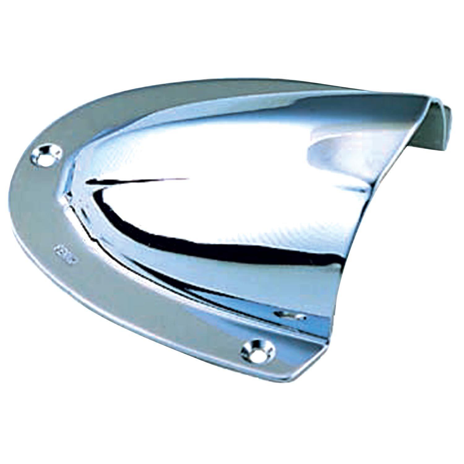

I don't have a picture of our installation handy, but we used a simple "clamshell" fitting (see picture below), installed facing down on a vertical surface over the hole for the wires. The wires have a small "drip loop" then proceed up the backstay to the bimini, where we have quick disconnects to the panels. The hole for the cables and the clamshell is bedded down with butyl tape, which I think works better. Whatever you do, don't use 5200 for a job lot this -- its over the top and will never be removable without probably inflicting damage (at least use 4200 if you don't use butyl).

Thanks Kevin, that's helpful.  I may just go ahead and try this deck plate.  Worst case I will have some screw holes to patch.  I also have other bigger things to worry about :)
