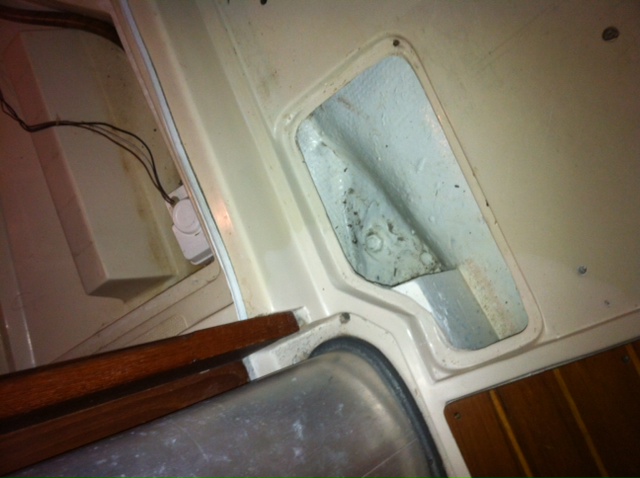

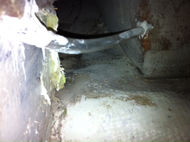

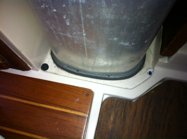

I spoke with Kent Nelson, the Catalina engineer. He didn't really say I was wrong about the need to use bronze instead of stainless steel below the waterline but he also didn't seem too worried about the stainless steel keel bolts either. He came up with a good idea on it:
Cut a PVC tube large enough to surround each keel bolt and epoxy it or 3M 5200 it around each bolt to keep the water out. If water ever spills over the top and into the small pvc area, just dab it out with a dry cloth.
I went ahead and created my drain into the shower pan instead. Simpler/quicker. Pictures are attached. I simply plugged the second hole in the mast step with a rubber plug, so that all the water that comes down the mast will drain into the shower pan. If I leave the boat for a long time, I will simply take out the rubber plug and accept that the bilge will be wet for that time period.
Up until today when I took the boat out into the bay, the bilge has stayed completely dry. There has been a small drip into the aft section, but I just left a sponge there to sop up that little bit.
Notice the small bit of rust on the keel bolt washers. I wonder if I should be concerned. (As I said, Kent doesn't seem to be...but then it's not his boat. :-)
My new problem is that every time I sail the boat, there is new water in the bilge. I can't trace it yet. My top suspect is full water tanks, since I noticed when I top off the tanks, there is always a bit more water in the back of the bilge. Not enough to wet the bolts, but still significant.
Somehow (how?) I need to figure out if it is salt water or not. I'm too chicken to taste it. :-)

benethridge's picture
benethridge
Joined: 5/13/09
Posts: 446
I'm starting to believe that a dry bilge is actually possible. I have my mast step draining into the shower sump, as I described earlier. That's working out well thus far. And once I solve the aft mini-bilge minor leak next time I haulout, that one will be dry. And I have one more in the anchor locker that I think I can solve with a drill and some 3m 4200...
So like Maine Sail, even with my little leaks here and there, with a good, large sponge and a few shop towels once a week or so, I've had a totally dry bilge in the keel bolt area for a month or two now.
Ben Ethridge
Miami, FL
1984 MK1 Hull# 263

Do either of you have any pictures on your mast sump modifications? I know I'd be interested in this project.
benethridge
Joined: 5/13/09
Posts: 446
See post #19 on a previous page of this forum thread. Just make sure the tube flows slightly downhill to the shower sump.
