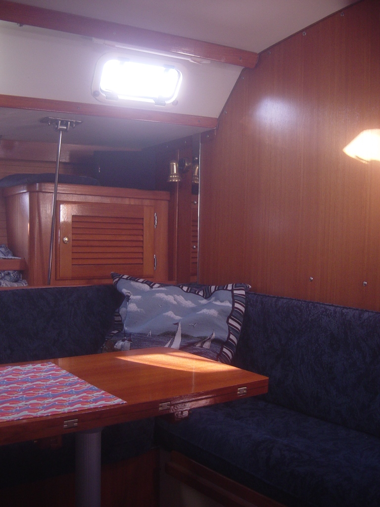

Agree with Capric, your weight has to be directly over that post to get the table down. I made a folding table (see pic). I can now stand with the post right at my feet and push down directly over the post. It goes down easily; once down, I open the table. Prior to this, my wife would be up on the table slamming away at it and it was still a struggle.
