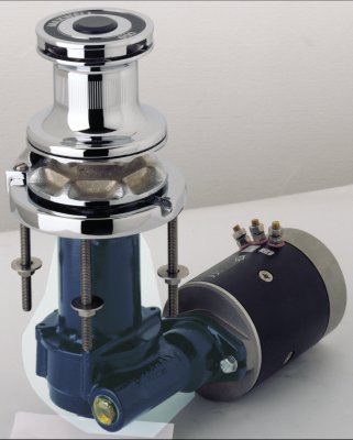

I don't know what model you have, but it sure sounds like the clutch is slipping. I have a VW1500 like in the attached pic. If you look at the top, just above the rope drum, there are slots in the top ring. You insert a bar in there and tighten/loosen the clutch as needed. I have mine set so that it will slip only under a very high load, but normally pulls the anchor out of the Chesapeake mud and up into place without slipping. The clutch can also be released to launch the anchor, if you have a self launching bow roller (I don't).
The manual for your winch should be on Maxwell's website, that might help you find the answer.
