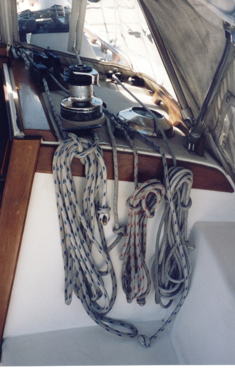

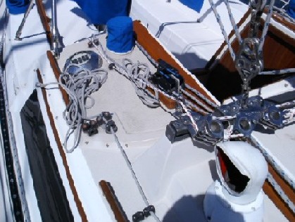

That's ([url]http://julandra.shutterfly.com/116[/url]) a great idea. On our boat the winches were placed inboard like that, but I still can't get the winch handle to turn 360 degrees. But before you do all that work, consider: it's a two speed winch, so I'm not sure why it's important to go all the way around. For both our port side winch for the reefing lines and for the starboard side mainsheet, I just go back and forth about half way and it works just fine. Maybe it's 'cuz our clutches are lined up and not that far off a fair lead. In looking at that picture again, I can see that the outboard clutches were led to the original winch position. Our outboard lines don't go to clutches, but rather to swiveling cam cleats which don't require the winch for the cunningham and rigid vang to port and the lazy jack to starboard. OK, I've just had an AHA moment! :)
