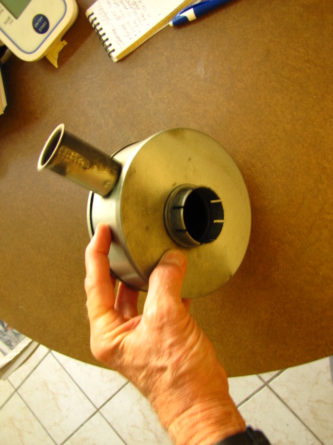

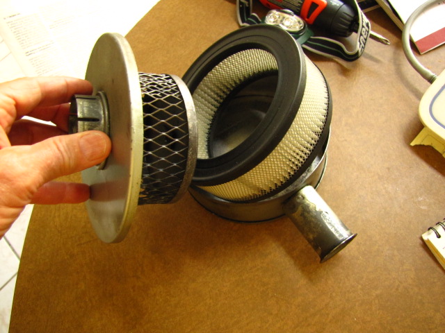

Thanks for all the replys to my origial post. I've solved my problem now and thought I'd share. I have the M35a Universal Westerbeke on my 1994 C36 mk1.75. It has a canister filter container, attached with a hose clamp and another small hose clamp holds the breather line from the valve cover at the intake of the filter.
I took the canister to my local CarQuest dealer, who has been very helpful in the past. He measured the canister and selected a perfect fit from his catalog. Only $7.21 plus tax. So I bought two. CarQuest part number CFI 87032
See photos.

Sam,
Thank you for the pictures, it makes me wonder if this canister type housing would fit on my M25XP. I would think it could reduce noise better than the open foam filter on my engine. The mechanical noise from the engine is fairly low, much of the sound comes directly from the air intake. It is quite dramatic how much just the foam element cuts down the engine noise, the extra baffle effect of yours should be more effective at reducing this racket and even give the ability to put a hose on the inlet to route the intake to a more remote location like under the aft berth to quiet things further.
With a paper element and the breather hose being held in the inlet, I may have a concern of this clogging the paper element, my foam element gets quite moist with oil from the breather. I have considered putting a fitting in the bottom of the filter canister to vent the fumes in downstream of the filter. If you did this it would eliminate the risk of plugging up the paper element with oil.
Steve

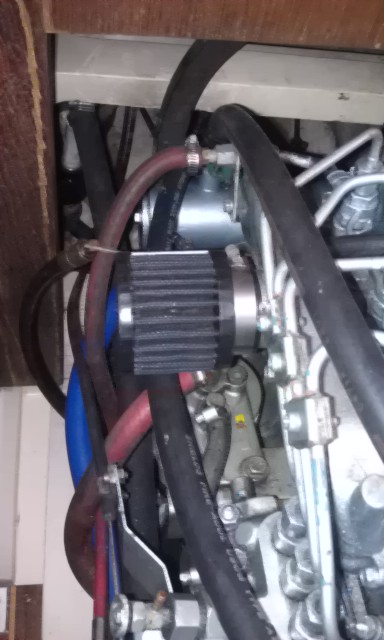

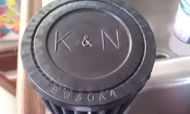

Sorry about being a a bit late but here are a few pictures of the K&N filter we use. The Number is on the picture if you care to google it.
