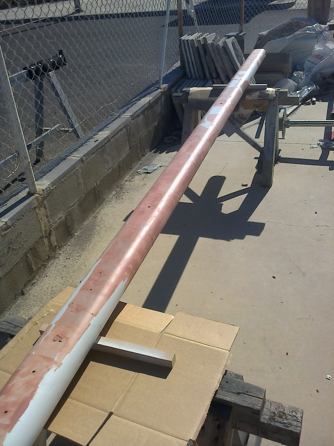

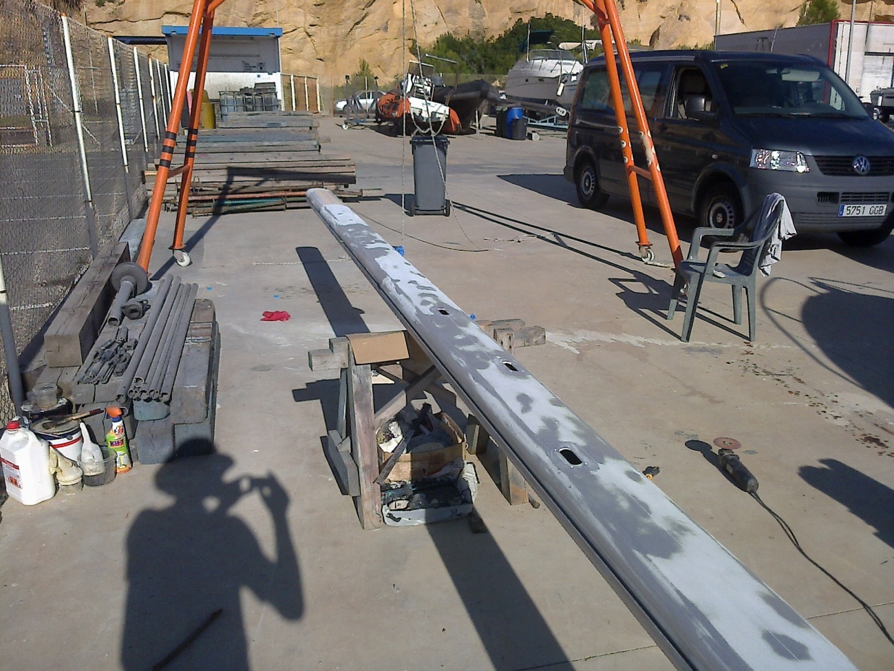

 Two winters ago, We did a full refit of our 1991 C36 mast & boom. Including all the electrical cables, sheaves, halyards, stainless steel parts, painting, etc...
Quite a rewarding work when you see the results.
Good luck!
PD, we did a full pdf document of the work done, including pictures and materials used. But it is in Spanish..
