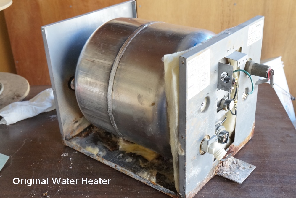

I just replaced my water heater. I mixed 50/50 distilled water with antifreeze in a water bottle and poured into the hose at the engine side using a funnel. At the return hose near the engine side I placed a foot pump that is used to inflate small toy inflatables and sucked air out while I poured in the fluid. At some point the fluid will squirt out of the pump. This means you have filled the hoses and the water heater coil. For me it took 22 Oz of fluid.
Be sure to fill the reservoir as well before starting engine to avoid introducing air into the engine.

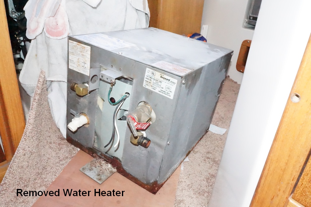

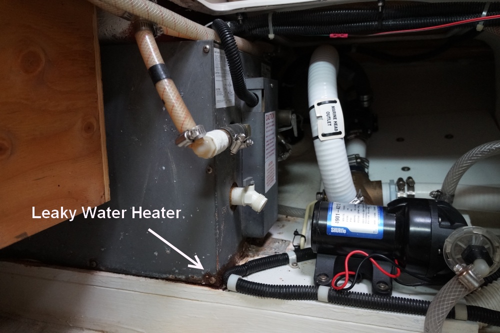

I had noticed that I was loosing antifreeze and having to add a few ounces each month, but had not been able to to locate the where I was loosing it. Quite accedently I noticed the cristal residue that indicated the loss of fluid.
Since the replacement of the water heater there has been no loss of fluid.

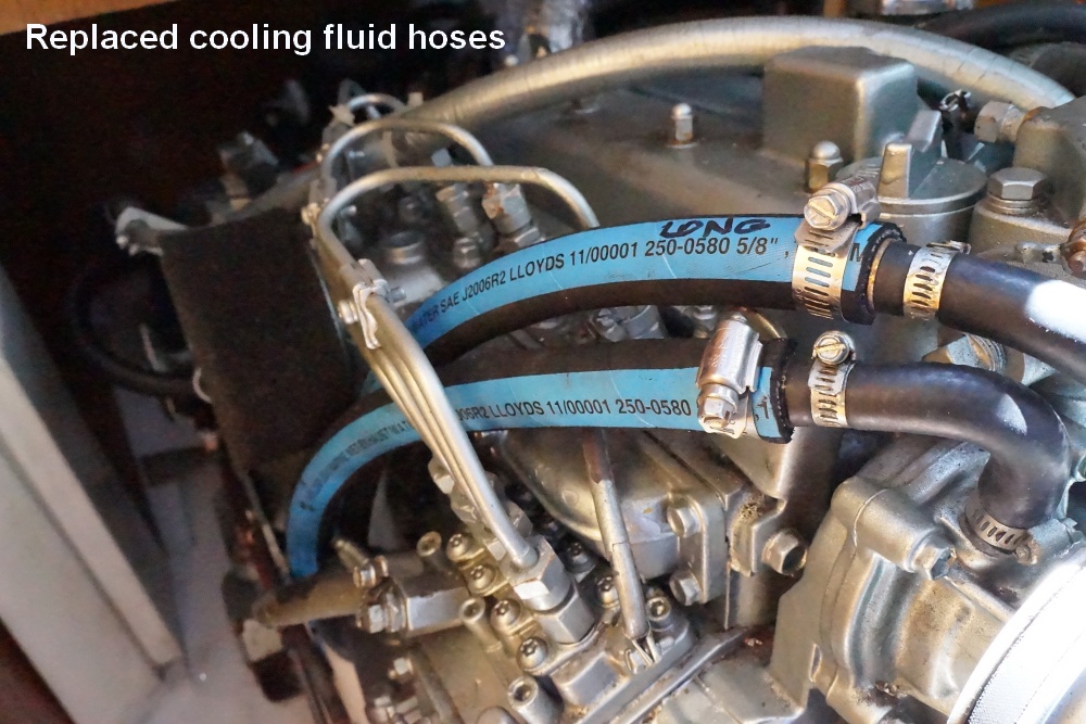

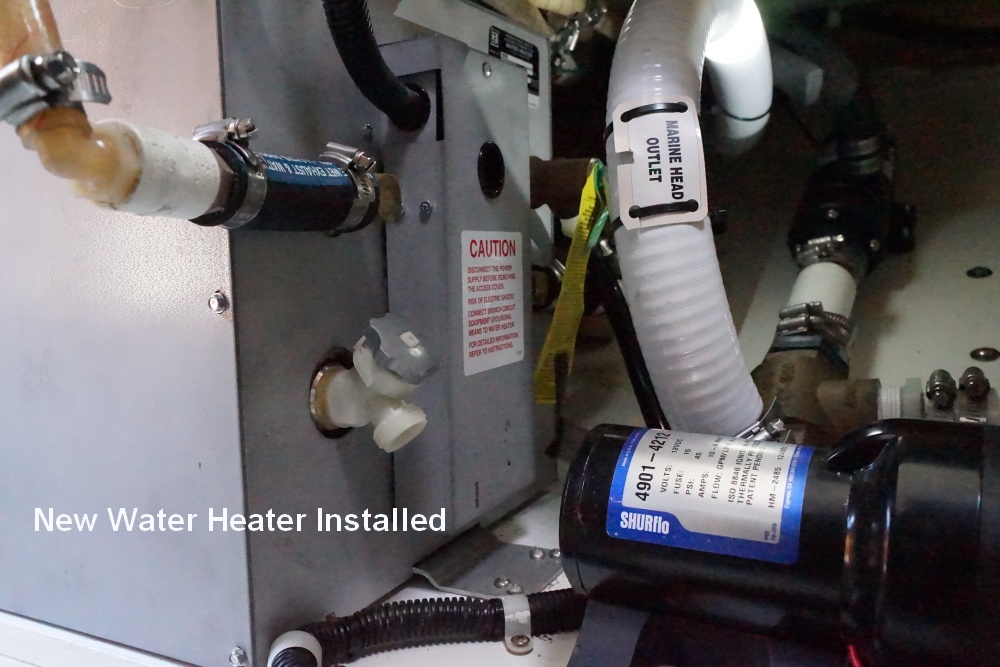

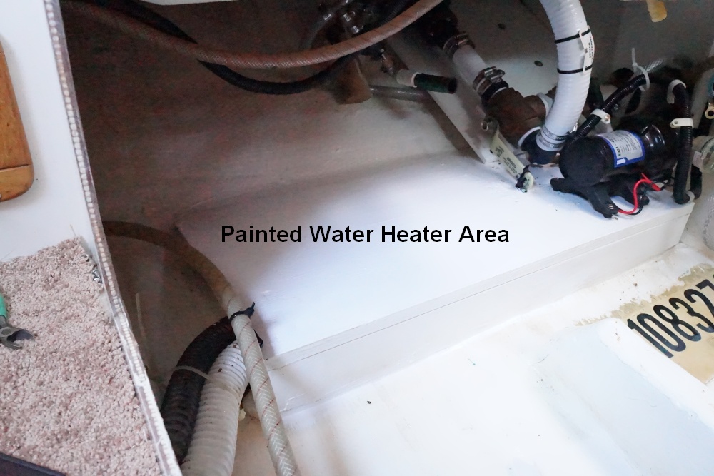

Here are photos of my installation. The hoses were 11' 8" and 11' 1' to the back of the heater.

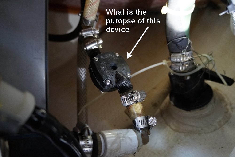

Does anyone know what the pupose of this device is that is located on the cold water input side of the water heater?
The last photo the square is a pressure regulator.

Thanks for the detailed reply. A couple of questions. 1. Are your new hoses automotive?
2. Are there any special “tricks” to get them from the engine to the water heater?
As for the device, I’ve always assumed it’s a check valve to keep hot water from rising into the cold.

The hoses are special, hardwall marine wet exhaust hose. That means it has spiral spring in it and resists up to 250F heat. I paid about $200.00 for 24 feet of hose.
It may also be a check valve. I have one on the pressure water input from the dock ( great method for sinking a boat if faucet is left on).

Sorry, another question. I didn’t pay much attention to which hose came off the back of the heater when I disconnected. From your pictures, is the hose labeled “long” the one that goes outboard?

Yes, the one labeled long is the one that is connected to the far side of the heater coil, near the hull, hence longer hose is needed. I marked them before removing in case the direction of flow makes a difference.

Done. 3.5 hours total; removal, install and test. Thanks for all your help!
