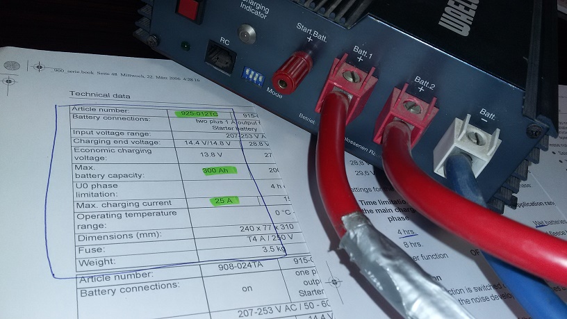

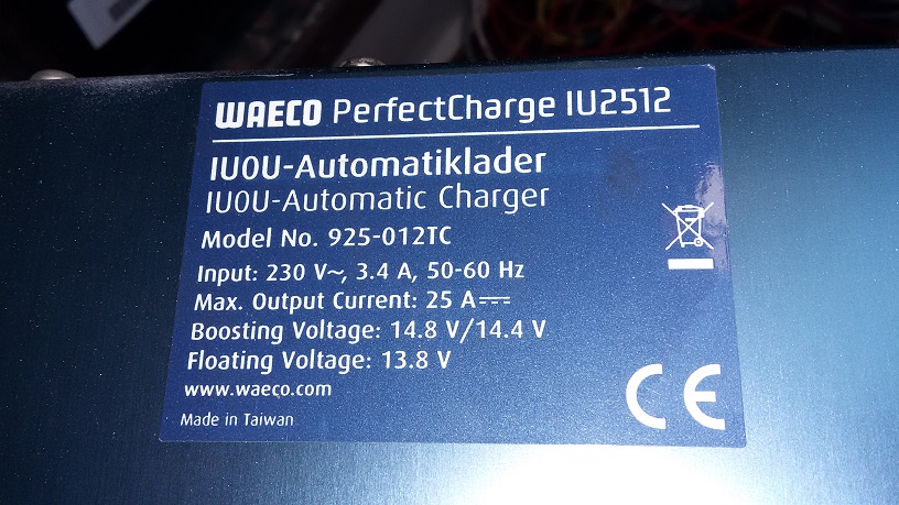

Hi to all!
I have a Waeco battery charger 925-012TC at my boat.
It is a 220V charger for my 12V batteries.
This year I changed my battery connections:
I've a second battery charger at my 25XPB. It is a 120Ah for VW, Audi, Skoda etc.
I expect ~50Ah capacity, at my cruise speed of 2000rpms.
The original charger is a Mando 50Ah. (Until today,  when it was connected to all batteries of 420A, it was really hot and unable to charge well)
I have 2*140wp rigid solar panels. And they give me 15A/h when the sun is good. And I guess a sum of 120A for 24hours)  We have the original fridge + Indel-B 35Lt deep freeze. We do not cruise often at summer time. After 48 hours staying at a bay, max 2 hours of cruise.  Almost every light is converted to LED.
I have 2*90Ah wet batteries for engine.
And 3*90Ah again wet batteries for house.
The total capacity is 540Ah. But my Waeco charger is max 300Ah.
And it has a capacity of max 25Ah (I think 12A+12A+1A - it has 3 output)
If the ideal formula for charging current for the batteries is : total battery capacity*10%/h
I need two types of 220V chargers :
For engine group : 18Ah
For house group : 27Ah.
But:
In general we DO NOT have enough time to charge the batteries via 220V.  (Because we do not prefer to sleep with neigbours just 2 feet away at the port of restaurants)
I need and prefer a charging capacity of 25%/h charger.
Which means ;
For engine : 45Ah
For house : 67Ah
What should I do?

Don't think you need 2 chargers.  We installed the Sterling Pro-charge Ultra, which separately charges both battery banks (it can handle 3 separate banks), and are quite pleased with it.  Specs are at
https://cdn.shopify.com/s/files/1/0658/7343/files/PCU_e978504d-63c0-4a7c-b13a-0f478876cfc5.pdf?706  , its available in various amp capacity (all the way up to 60 amps), and  suitable for 220v applications.   Europe distributor is at http://sterling-power.com/products/pro-charge-ultra
