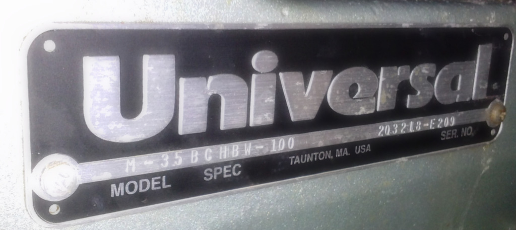

The M-35BC was an actual build by Universal/Westerbeke.  Enclosed please find a picture of the engine tag from my boat and a Service Bulletin listing the M35-BC as valid.  https://www.westerbeke.com/service%20bulletin/service%20bulletin%20235%2...
Rob is correct.  The differences are really in the wiring harness that was designed to mate with the Catalina-supplied NAVPOD panel on MKII boats.  With the exception of the wiring diagram, all manuals, parts, and supplies suitable for an M35-B can be used with an M35-BC.  The MKII Owners Manual should be used for the wiring reference.
