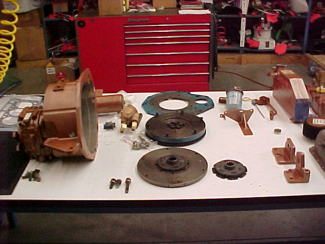

Keith, I posted a picture of the bell housing and components on the image's section. I do not know if it will be of any help to you.

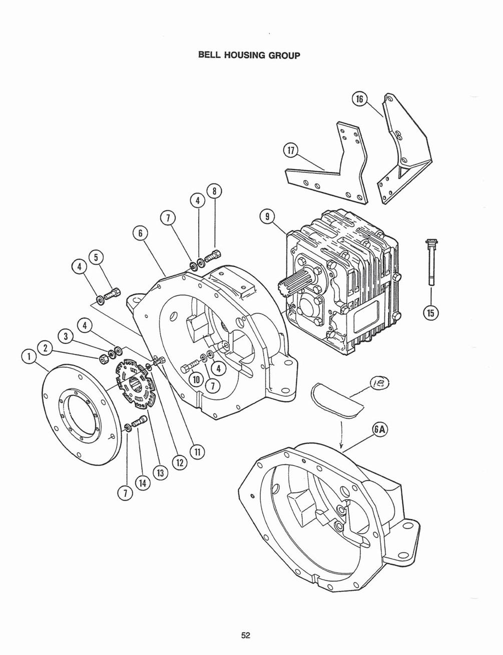

Keith:
I went and checked the M25 parts manual and sure enough my post may have been misleading...the M-25 mounts are indeed inside the bell housing (seems a strange design to this mechanical engineer -- I prefer fastners on vibrating components to be exposed so the torques can be checked).
I've attached the picture that shows the bolts go inside out (see #10).
Sorry for any confusion my earlier post with the M35 may have caused.
