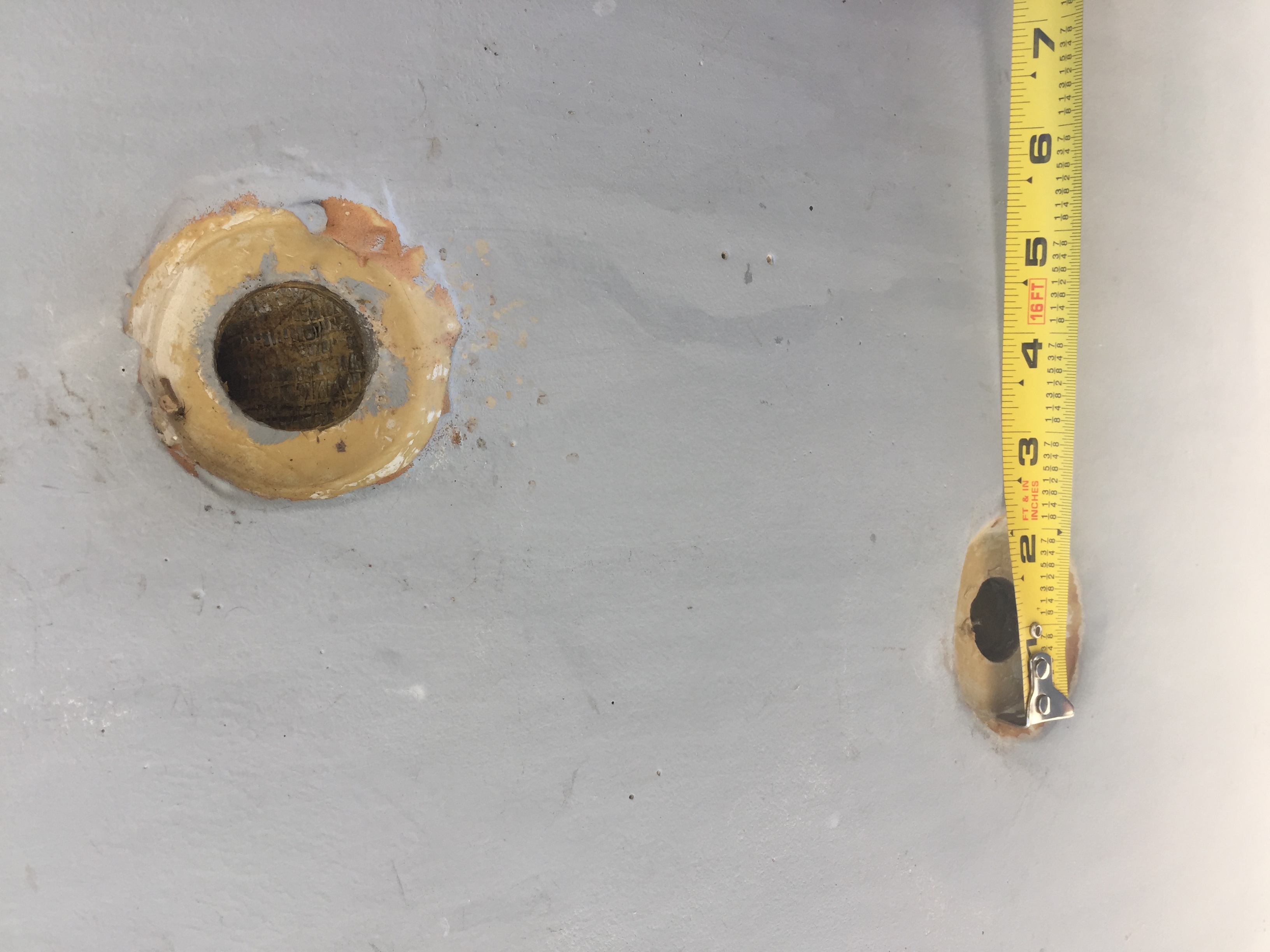

I checked the ID hole size of my head thru holes. I used a 1" and a 3/4" hole saw. One is a 1" cut out. But the other is between a 1" and 3/4" size.
I haven't found a thru hull fitting that's an in between size so the 3/4" fitting is what I use right?
The photo is of the two head they holes. The top is the 1" ID. Bottom is the odd ID size.

I'm not sure why you are using a hole saw? You shouldn't need one. To remove the old thru hulls, remove the hoses/clamps, unscrew the flange nut on the inside of the hull and push on the nipple (hose barb) to free it from the boat hull. Be sure that it is clear of bottom paint (which may act as an adhesive). Also, you might need a large adjustable wrench or pipe wrench to loosen the flange nut. The thru hull will probably be bedded in adhesive and you may have to rock it back and forth to break the bond from the hull. Be sure to remove all the old adhesive before bedding the new thru hull in poly sulfide sealant.  You can take the old thru hulls to the marine supply store to size for new ones. If you have used a hole saw to remove them, be sure that you have not enlarged the holes in the fiberglass hull. That may create a need for a whole new solution. Is there any boat yard worker that can help you?

All fittings are already out. Did a total bottom job and replacing all fittings. I used the hole saws to measure the ID size to make sure of the correct size for new thru hole fittings.
I posted a pic of the head they holes on here. Hope it can be seen.

Glad you were just using the hole saws to measure, not drill. Good luck finding the replacements; you may have to rely on more than one marine supply to find the right ones.

Good chance they were Forespar flush-mount thru-hulls.  A 1" hole is usually drilled for a 3/4" thru-hull and that is a common size for all head / sink / shower usages, corresponding to the usual size of the seacock inside the hull.  I'm surprised there are two different sizes holes as this suggests there are two different size seacocks.  Perplexing.  The smaller one suggests a 1/2" thru hull.  Can you tell if you have two different size seacocks on the inside of the hull?
