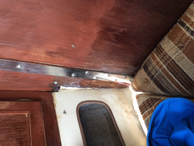

mpaquin
Joined: 4/18/16
Posts: 2
Hi. Just joined this site.  YHesterday, I acquired a 1984 C36, it's a project boat. The hull (fiberglass) very good shape, but much of the woodwork (dry rot) needs to be replaced.  Especially the main bulkhead in salon/head.  I'm familiar with the process - build the inside of a Corbin 39, in the late 80's.  Also, I specialized in advanced composite (fiberglass and carbon fiber) to certified aircraft plastic part, and I have a fully equipped 3,000 sq/ft hangar - FAA certified Airframe and Powerplant.  Enough for the credentials - l I can do the work.
I'm used to schematic and drawings.  Does anyone know if the schematic and recommended materials are available to install new bulkheads and other woodworks.
Marc Paquin
