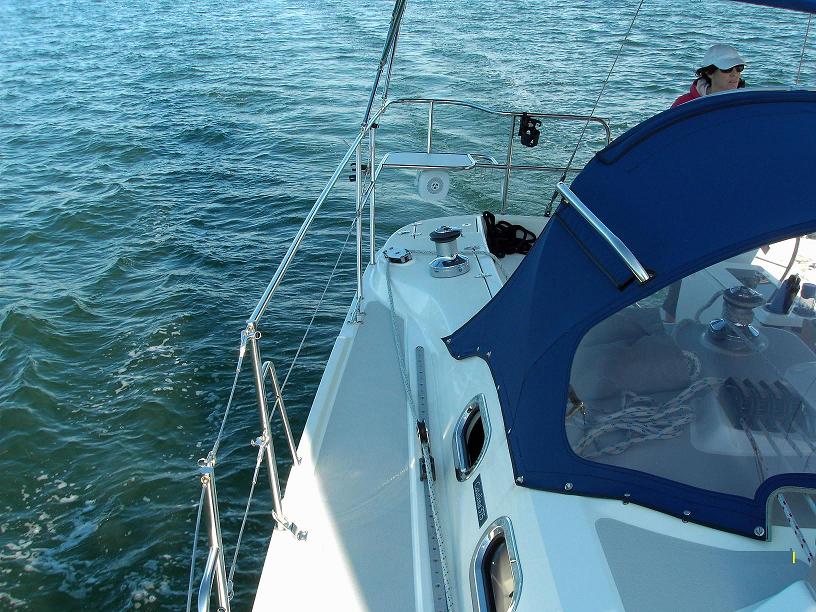

We added some additional stainless tubing between the pushpit and the midship gate. This gives you a good strong handhold as you enter/exit the cockpit.

I'd be interested in hearing any details you can provide on this. Did you have a railing specialist like Railmakers do it? Cost, Etc... BTW, the gate on my '91 is much wider than yours. Is this just the way the MK IIs are?

The rails were welded in by one of the local stainless steel fabricators.
You cannot see where he joined it onto the factory stainless pushpit, as the welds were polished.
The job was not just adding the top tube, but he also had to cut and weld in the upright on the existing tubing.
All the work was done while the boat was on the water (in its pen).
It cost me $400 to have these added. We think this was worth it. it just gives you something solid to hold onto when entering and exiting the cockpit.

Thanks for the info. Oops, I didn't notice yours is a 375. I've liked that idea ever since Caliber Yachts started doing it. Not only a good hand hold, but it gives you more space for BBQs, etc. Seems worth it to me, and perfect timing. I'm about to redo my lifelines.
My father replaced all the lifelines on his boat with stainless tube. He cut them to size and prepared them for the welder. The welder did the welding, and dad ground and polished the welds. As labour costs are the largest component, it was pretty cheap (from memory).
