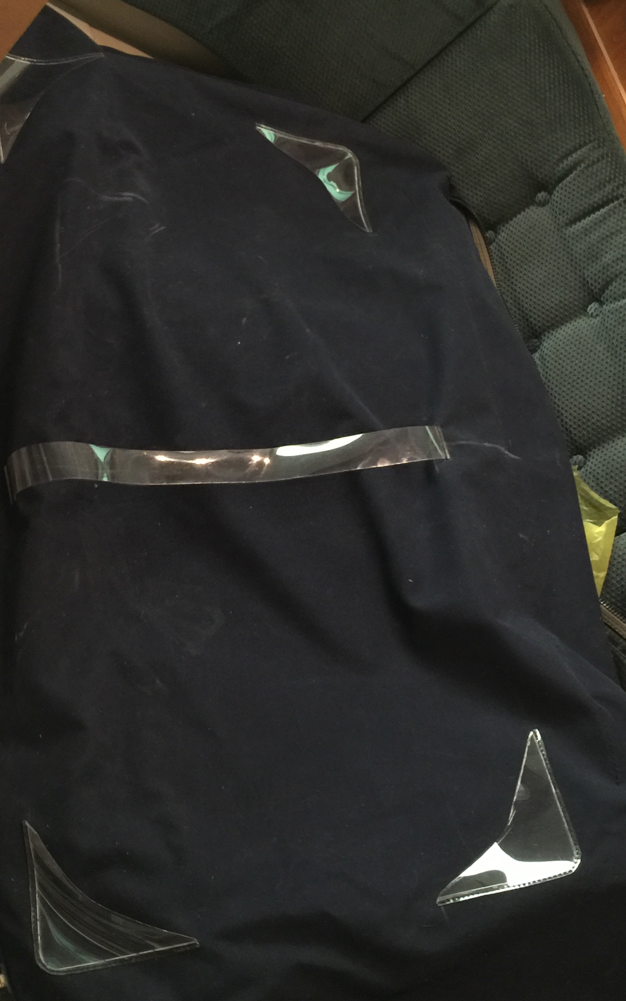

Enrique ~ like you I researched flexible panels from both Hamilton Ferris and (as mentioned in another post) decided on a GoPower! two-panel + controller set up from Defender due to price and manufacturer warranties.  I had called Hamilton Ferris to purchase just their snaps but they will not sell those attaching snaps alone.  Was then thinking about Velcro patches on my bimini but after speaking to my local "canvas guy" -- he had another idea.  Using pieces of Lexan (dodger window material) he cut and sewed four corner pockets and a single strap going across the middle of the panel.  I think it's an awesome idea!!!  Since the panels have some flexibility I simply slide the panel under the middle strap (going fore to aft), slide the two aft corners of the panel into their pockets and then with a slight bend of the panel can fit the two forward corners into their Lexan holders.  The panels feel super secure and the strap/corner pockets are a clear material to prevent shading.  Best of all 8 pockets and 2 straps were around a $100.

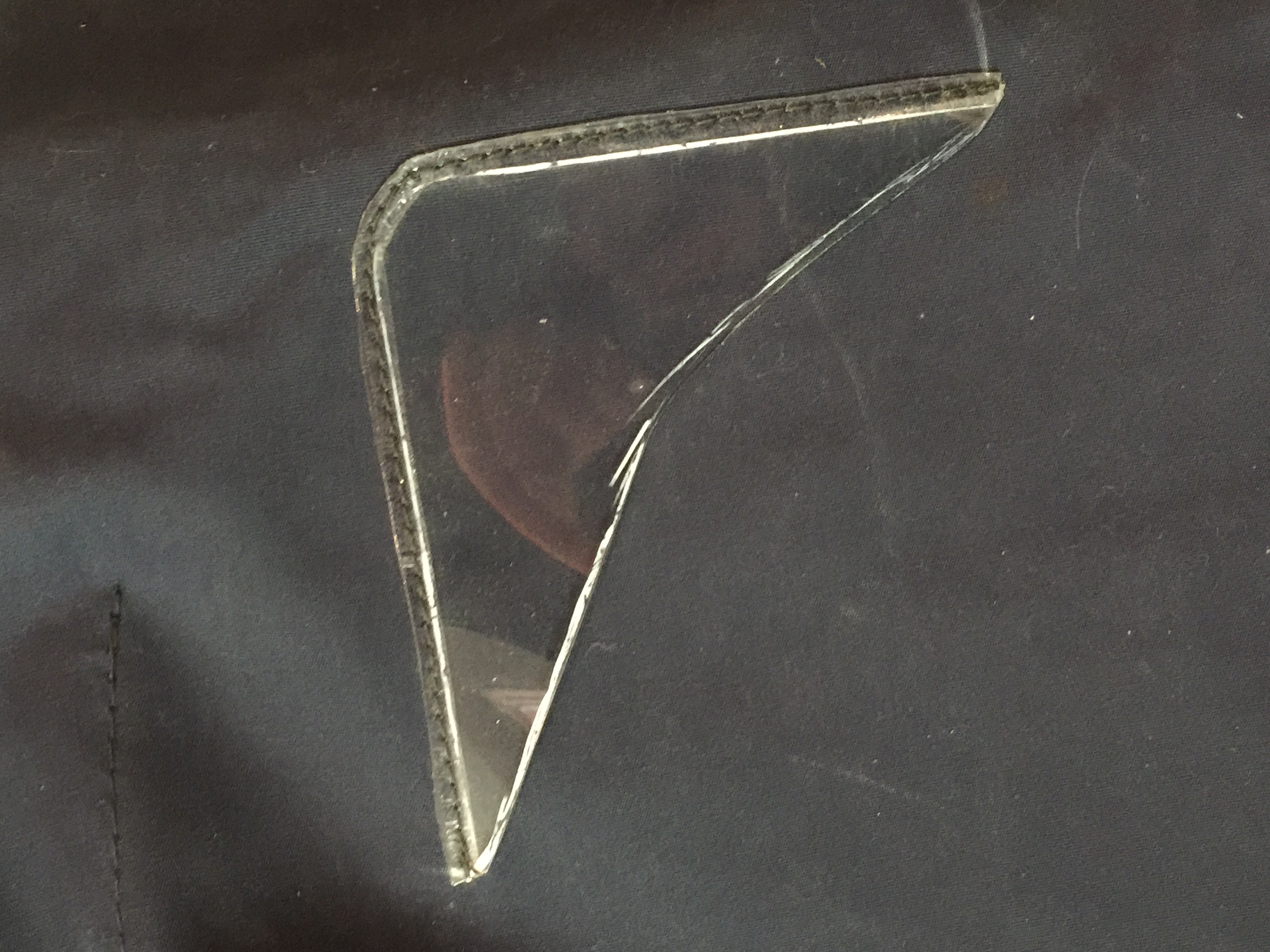

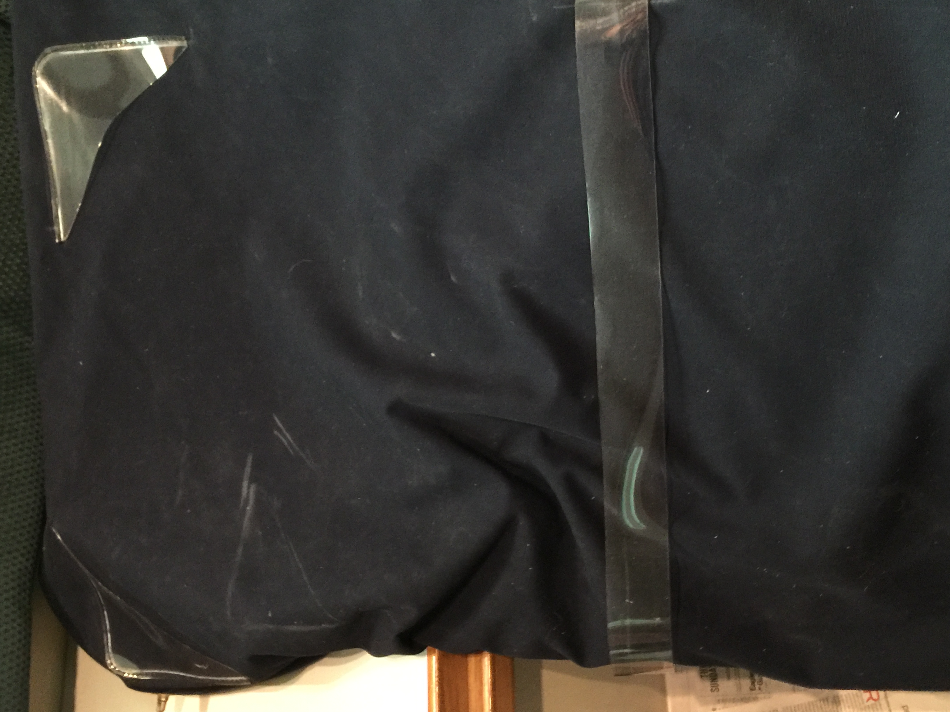

Enrique ~ here are some pics of sewn-in pockets and middle cross strap I tried to describe earlier.  I hope they give you a better idea of my solar panel set-up.  If needed I can email these pics to your email address.
Dave

Enrique - having trouble downloading all photos I have.  Let me know if you need more.
Dave
