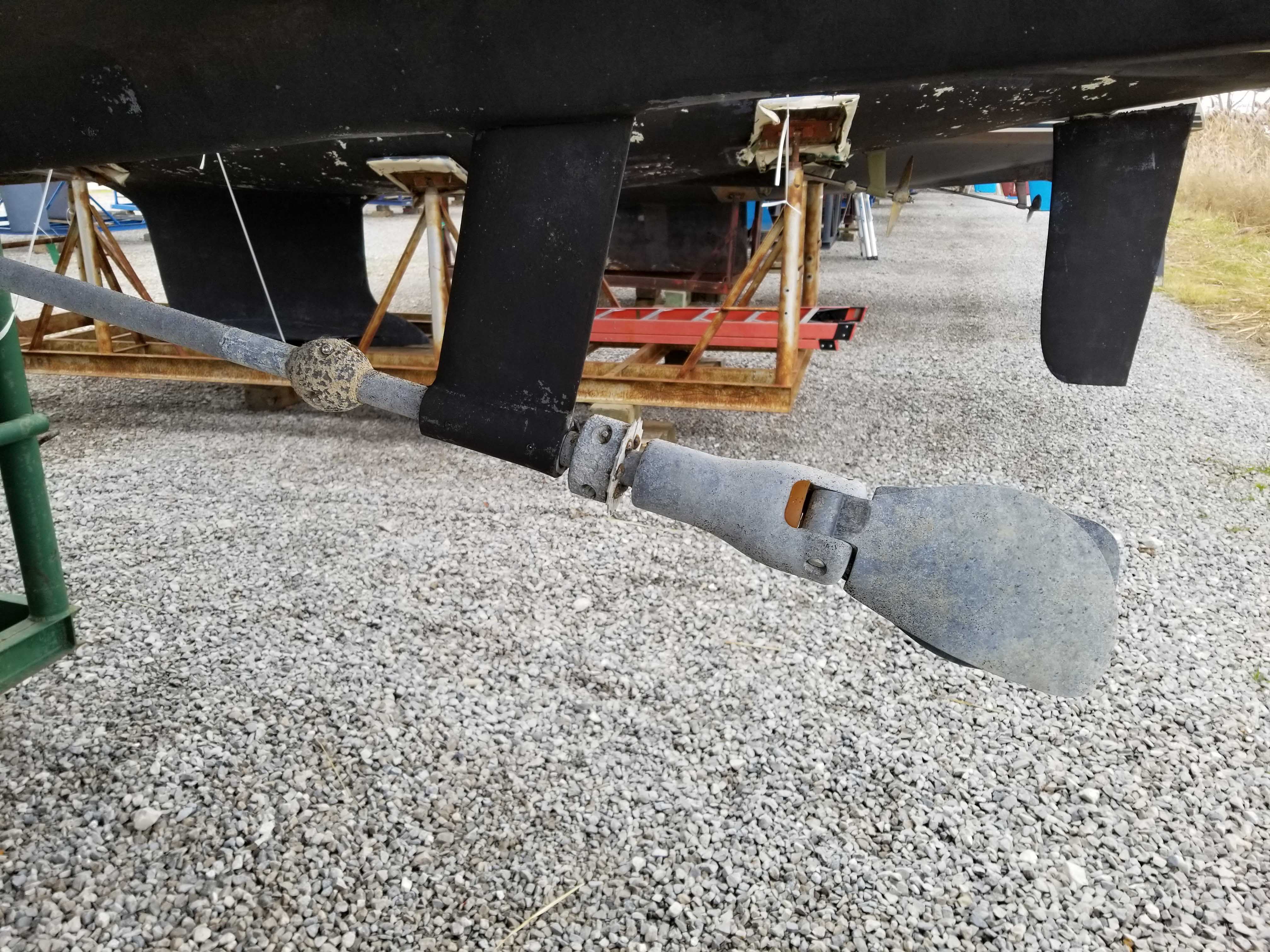

I actually have two anodes on the shaft.  I have this line cutter anode between the prop and the shaft strut.  It's tight but it fits fine, and you want the line cutter close to the prop.  I have a regular magnesium anode on the shaft just forward of the strut.  I will snap a pic this weekend and post it.

I finally got a picture.  The line cutter is between the strut and the prop.  I have another magnesium anode upstream on the shaft, which probably needs to be replaced.
