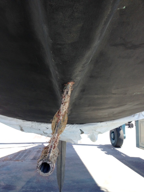

I have a 1984 36" Catalina MKI, I am looking for a replacement Strut, a portion has been eaten away and I aw unable to get the cutlass bearing out without the Strut breaking apart. Used would be fine if anyone knows of a source.

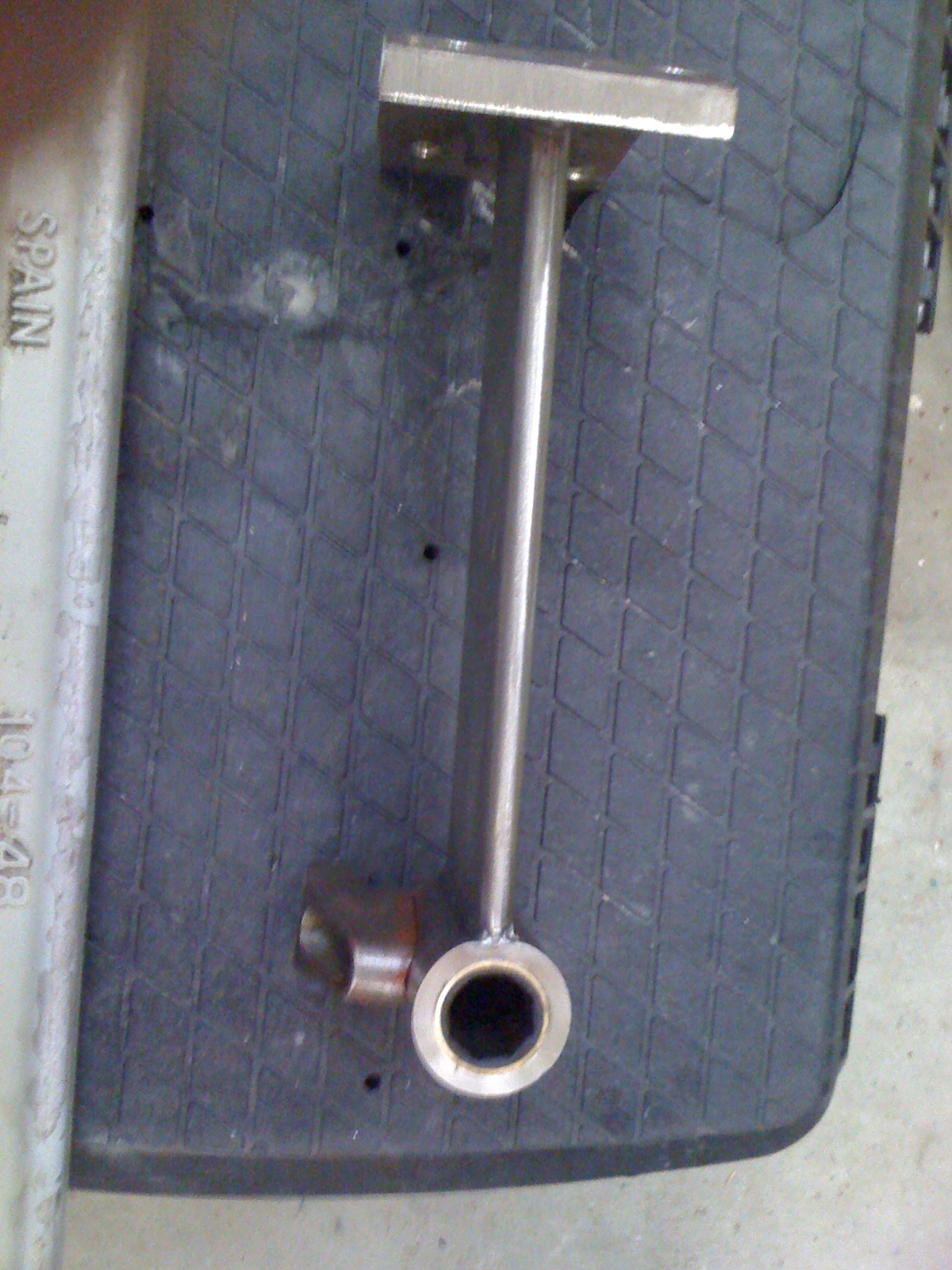

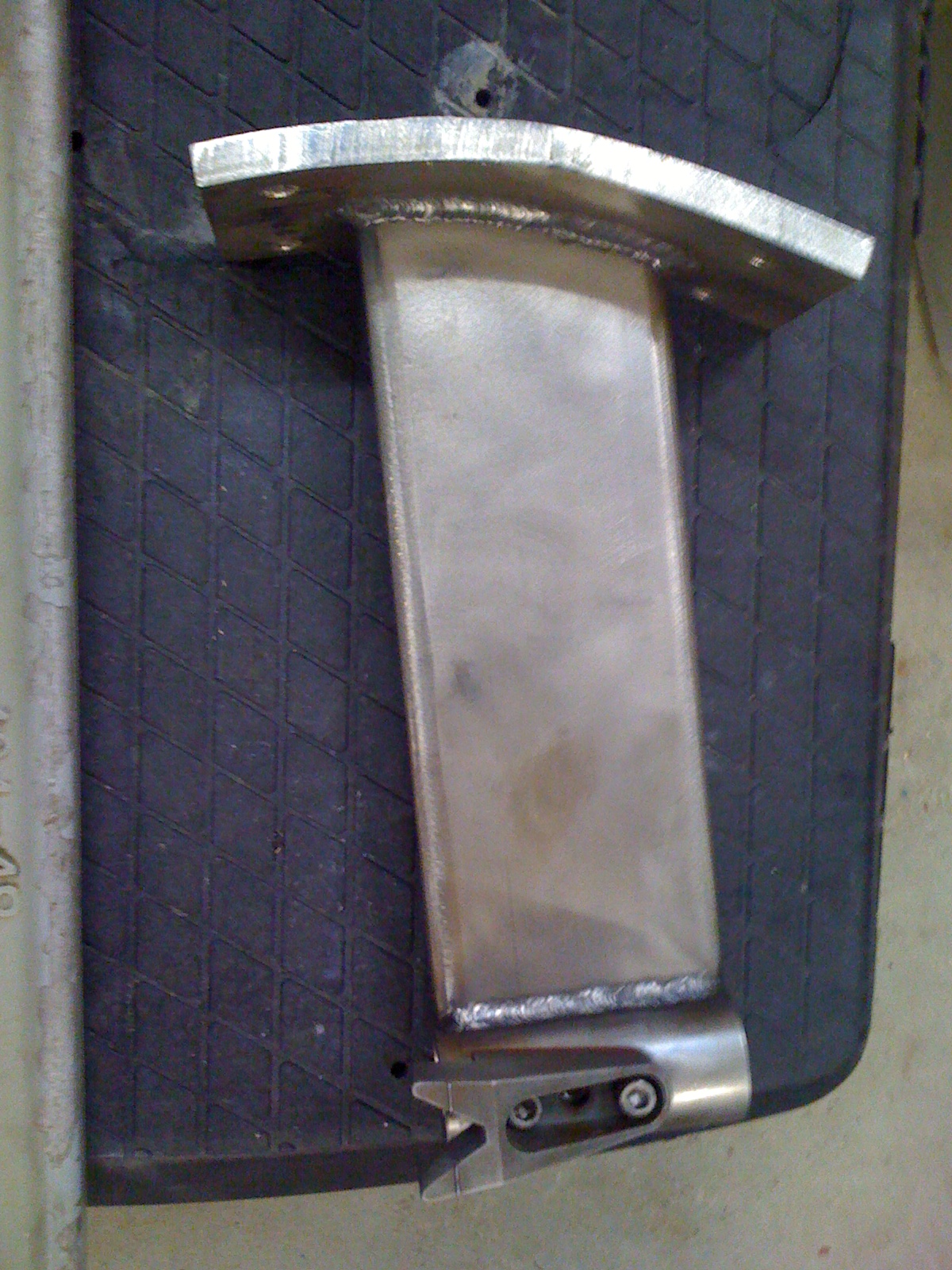

I had to replace mine a couple of years ago as it was just crumbling. I contacted Catalina and Catalina Direct and they did not have them but they gave me the manufacturer's representative who could get it for me on a rush basis for what I thought was an extravagant sum. The owner of Bittersweet Boatyard where I store my boat thought he could get a local fabricator to make one out of stainless steel and I believe the cost was under $600. What I had made was to have the heaviest cutlass bearing for a 1" shaft I could get. Reason? Here in Maine lobster warps can be a real issue and I have used Spurs for  close to 39 years. Problem I experienced over the years is electrolysis eats away at the tapped hole. I was able to increase the size of the support for the cutlass bearing by using a larger diameter SS Pipe welded on to the base (Remember I said fabricated strut).  Anyway it has been about 4 years since I have done this. I had initial concerns on the weld , but my fears have not proven true and I suspect the fabricated strut will outlive the hull.

You can buy them from Catalina Direct.  I had to replace mine in November 2014.  The one they shipped looked a lot stronger than the old one, which had broken.  Attached is a photo of the new strut during the first step of its installation and after completion of installation. The strut comes complete with the cutlass bearing. I got help form a boatyard's fiberglass and epoxy expert to do the work.
