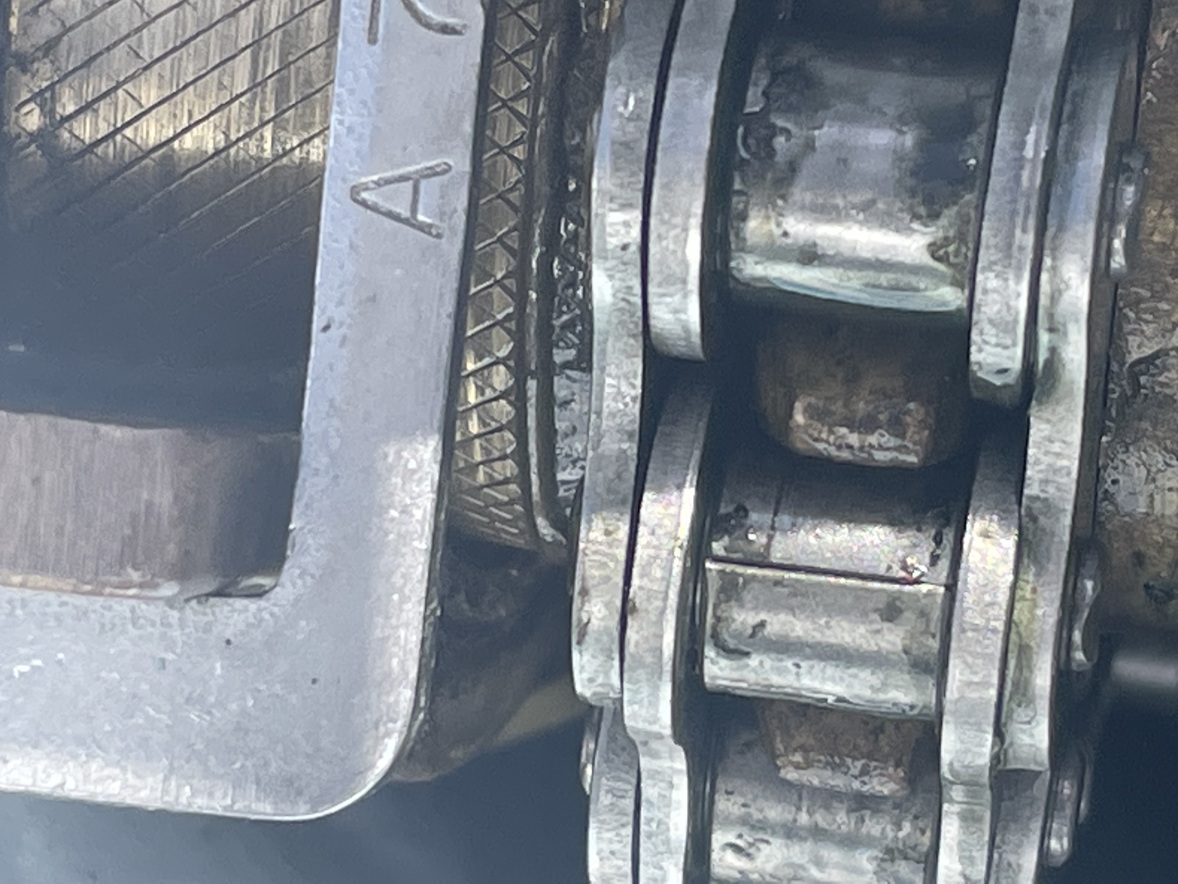

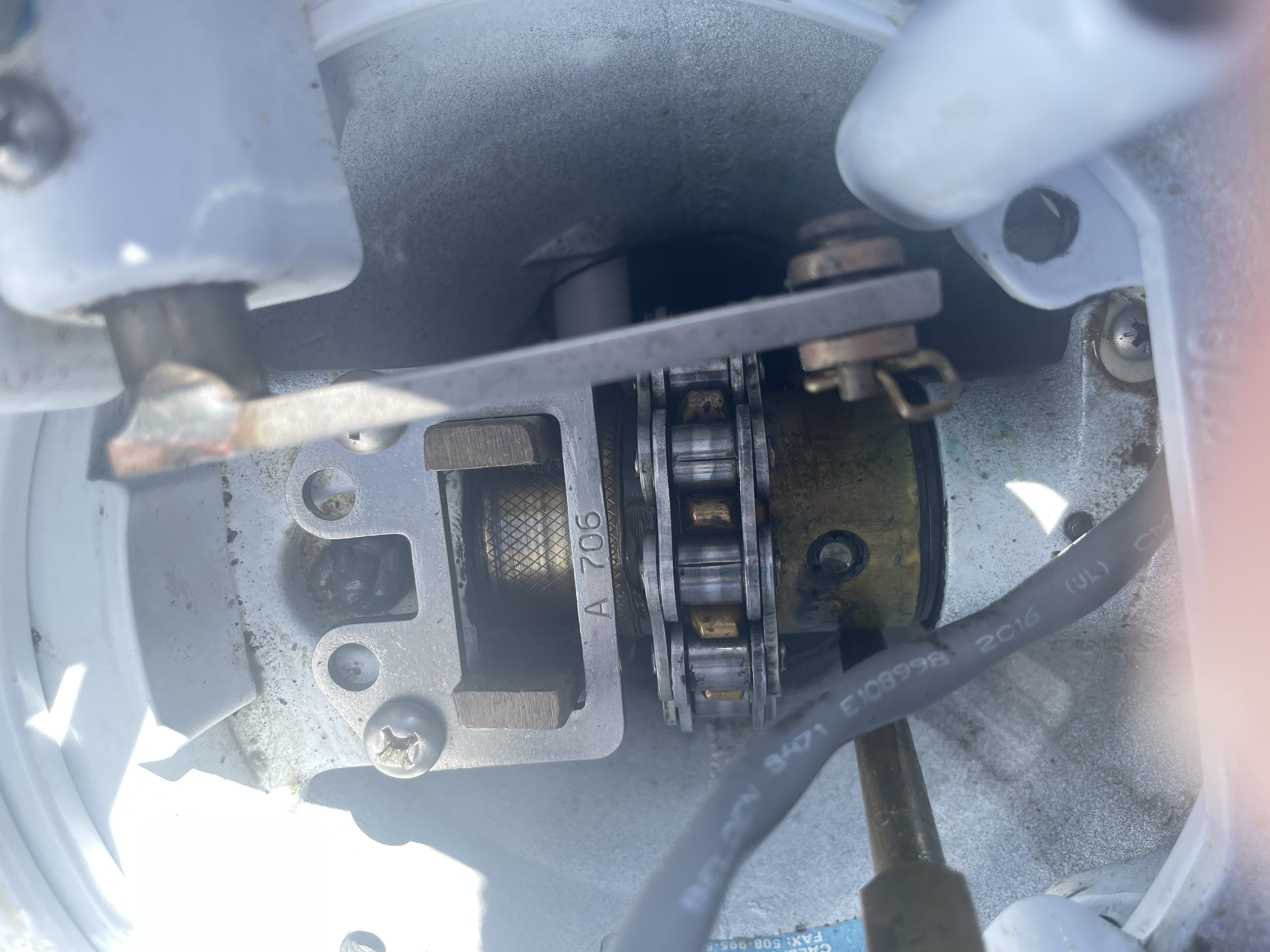

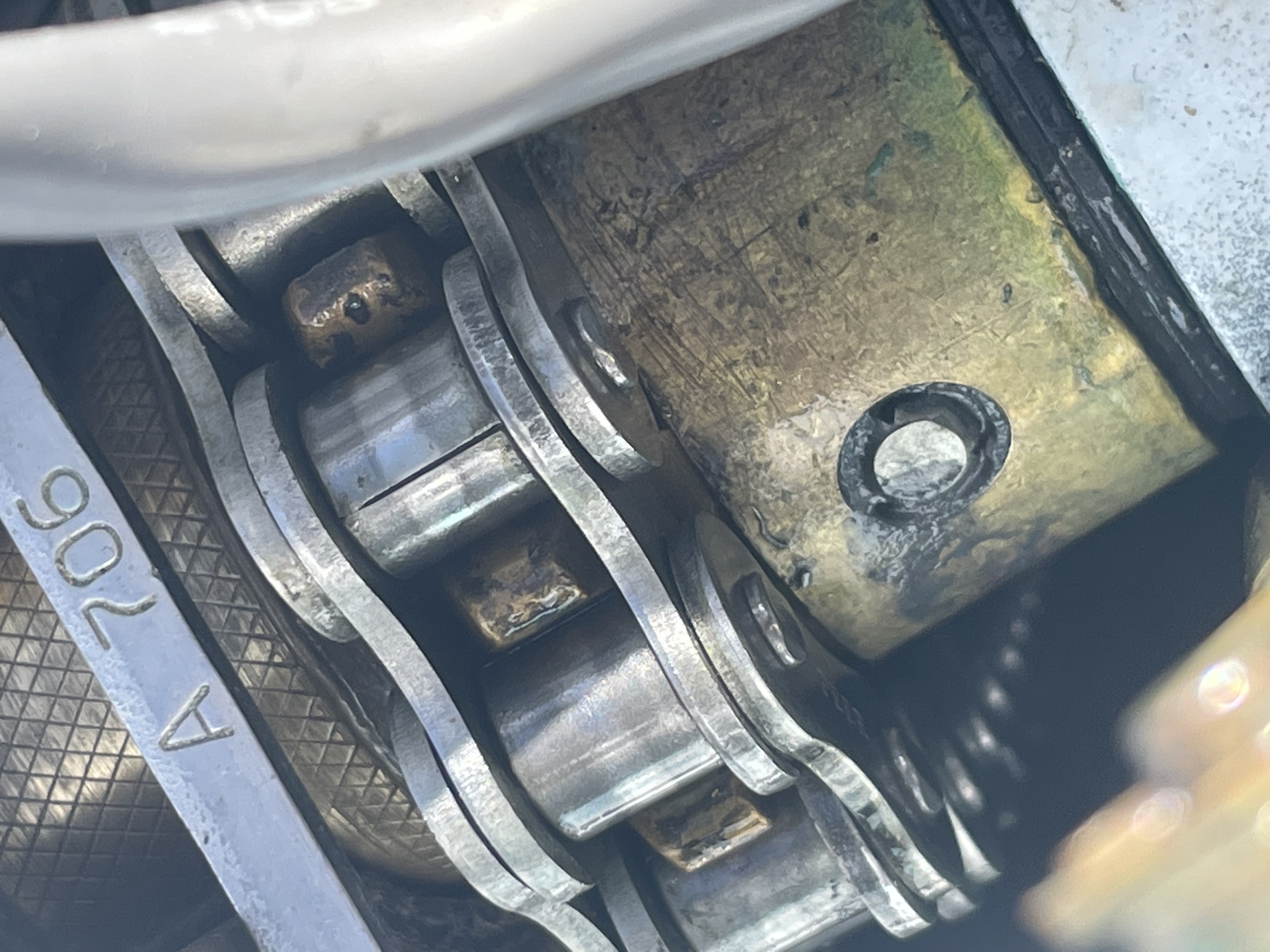

In general, things looked good and clean when I got into the binnacle, especially for a nearly 30 year old boat. Steering, which was good before, is now silky smooth after some fresh lube. But I did see one thing inside the pedestal that I'm wondering about. In several of the chain links, there was a straight line across the roller. Since I noticed it on so many (at least 8) and they appeared uniform and straight, I am wondering if it is a manufactured seam or a crack and sign of wear, pics below.
Has anyone noticed anything like this on a new chain? I'm a firm believer in fixing what's broken, and leaving be what's not while conducting regular preventative maintenance. I'd love to hear what others who have replaced their chain and cables think. Thanks in advance.

I would suspect they are stress cracks, especially if only a few rollers display it. Are they found mostly at the top/middle of the chain? Those rollers would likely see most of the gear contact and action. I'm guessing the rollers get repeatedly and slightly squeezed as they travel between the gear teeth and this maybe lead to fatigue/stress cracks.

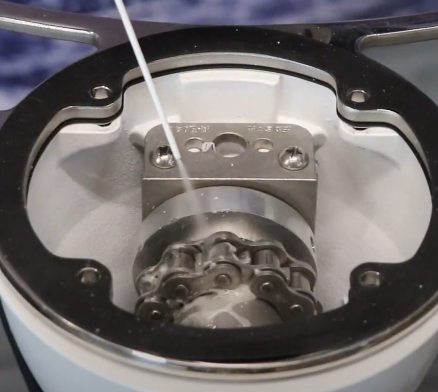

Thanks, Paul, I actually found the answer looking at this tutorial: https://youtu.be/SqYSXfKaWro.
If you watch the video of this brand new chain, you'll see several seams pass over the top of the sprocket, just like the do on my boat. I've attached a few screenshots where you can see the seams near the 12 o'clock or 1 o'clock position.
I also reached out to Edson and they confirmed that prior to 2018-19, the chain rollers had seams on them. They changed suppliers after that, and the current, new chains do not have the seams. All of my components looked like they are still in really good shape, and steering is now baby smooth, so I think I'll wait another season or two before replacing them. It is good to know what I was looking at was the design and not a failure in the chain itself.
