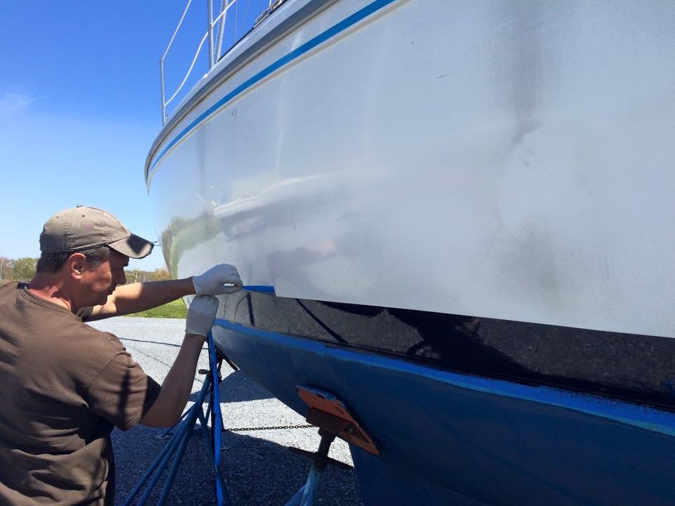

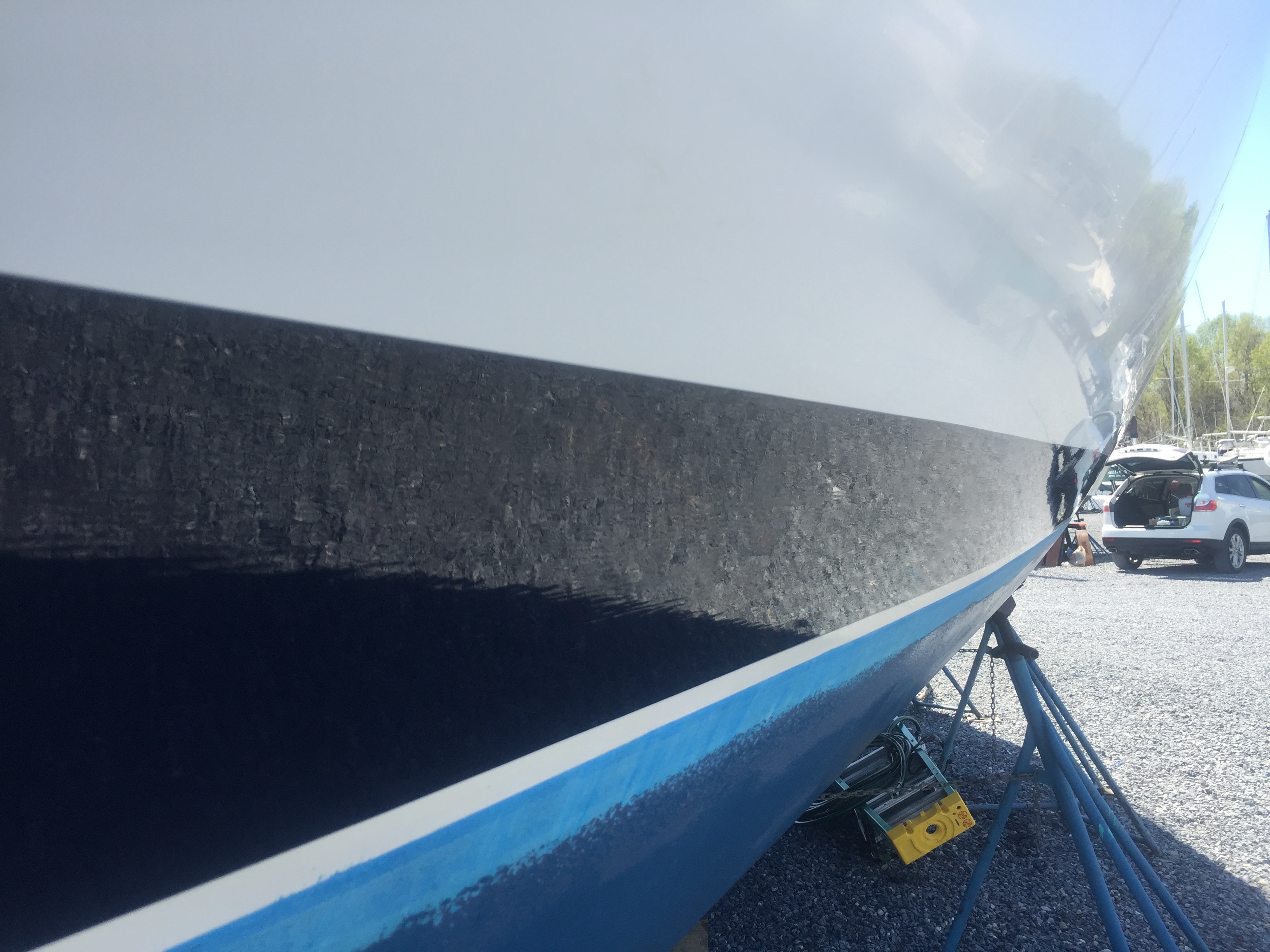

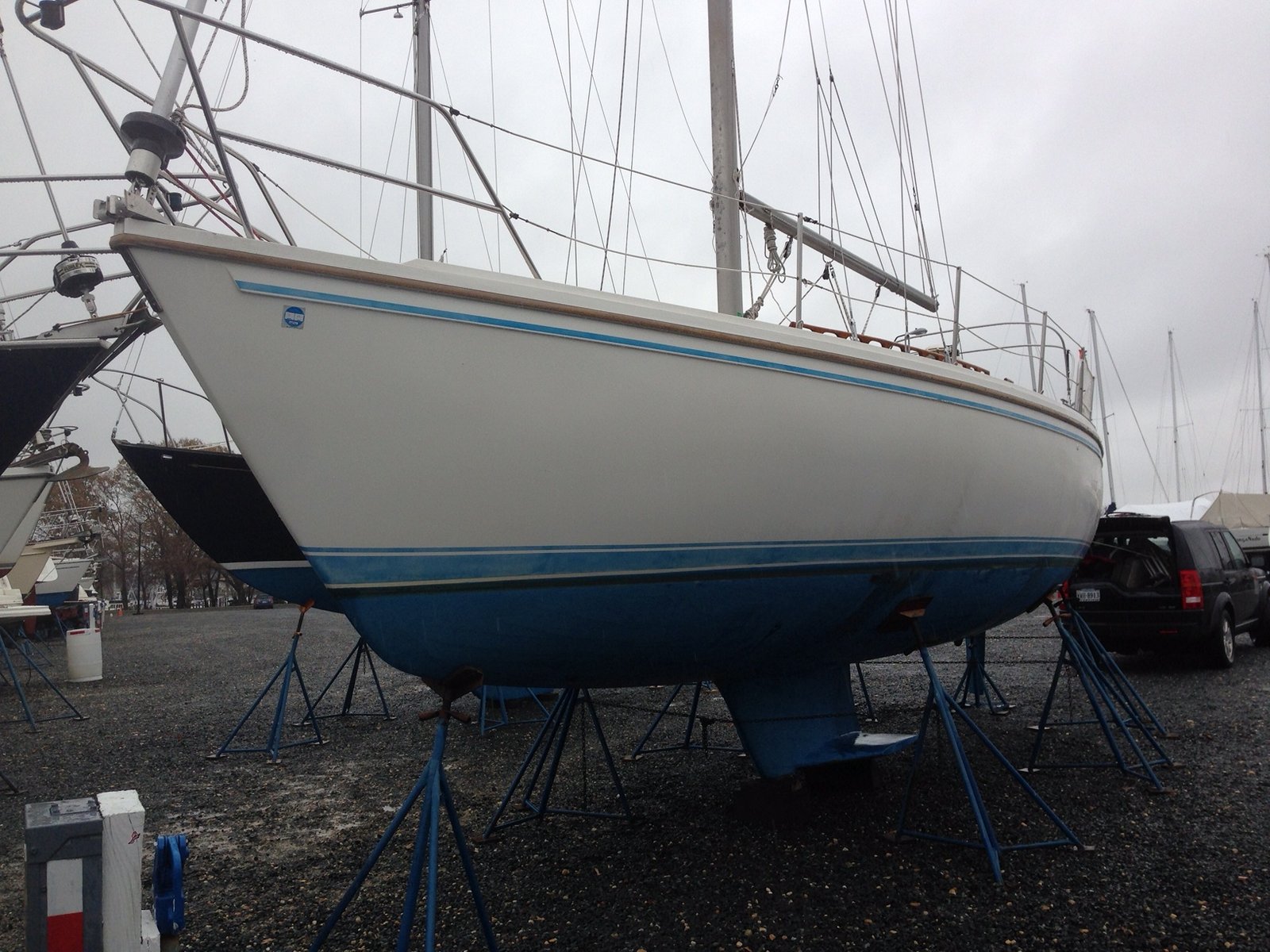

The boot stripe can be brought back.  Here is my before (haul for survey) and after (following spring launch).  Removing that 28-yr old brown rub rail with a new one grey goes a long way too.

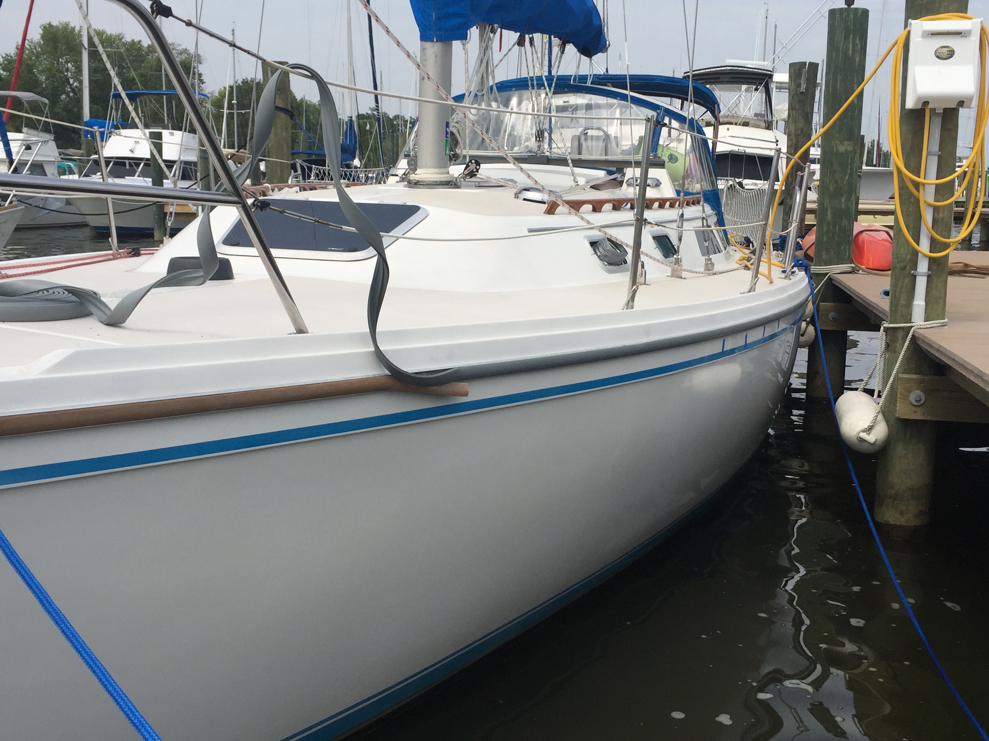

This year the Admiral wanted a change....  so we painted the boot stripe and tried two colors of grey 1.25" wide vinyl for the upper stripe but couldn't find the right color match.  So launching with the oem upper gel coat light blue for now.  Will revisit next year.

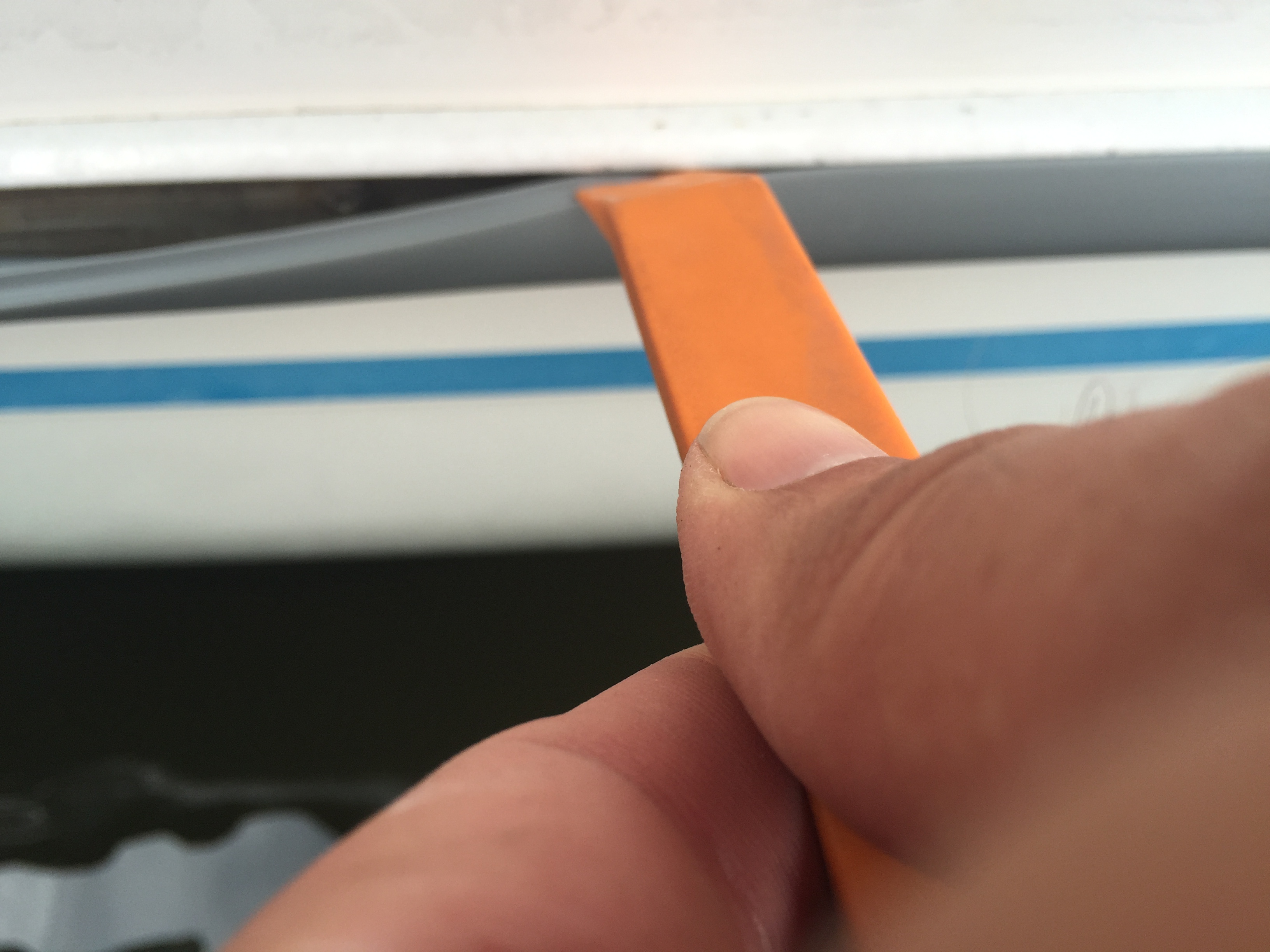

It takes a minute to figure out what combination hand tools works best.  What worked best for me was inserting a few inches in the bottom track by hand, then using a plastic body panel to to insert/push then work the top portion completely into to top rail, an inch at a time while keeping a few inches in the bottom rail inserted ahead of the top rail.  Overall, it took a few hours, but easy work.  After removing the original rub rail, clean the groves inside the aluminum track and open up the grove if sections were bent in over the years.  I also filled several holes through the track where the prior owner used screws to secure the original rub rail.  Guess it fell out over the years.

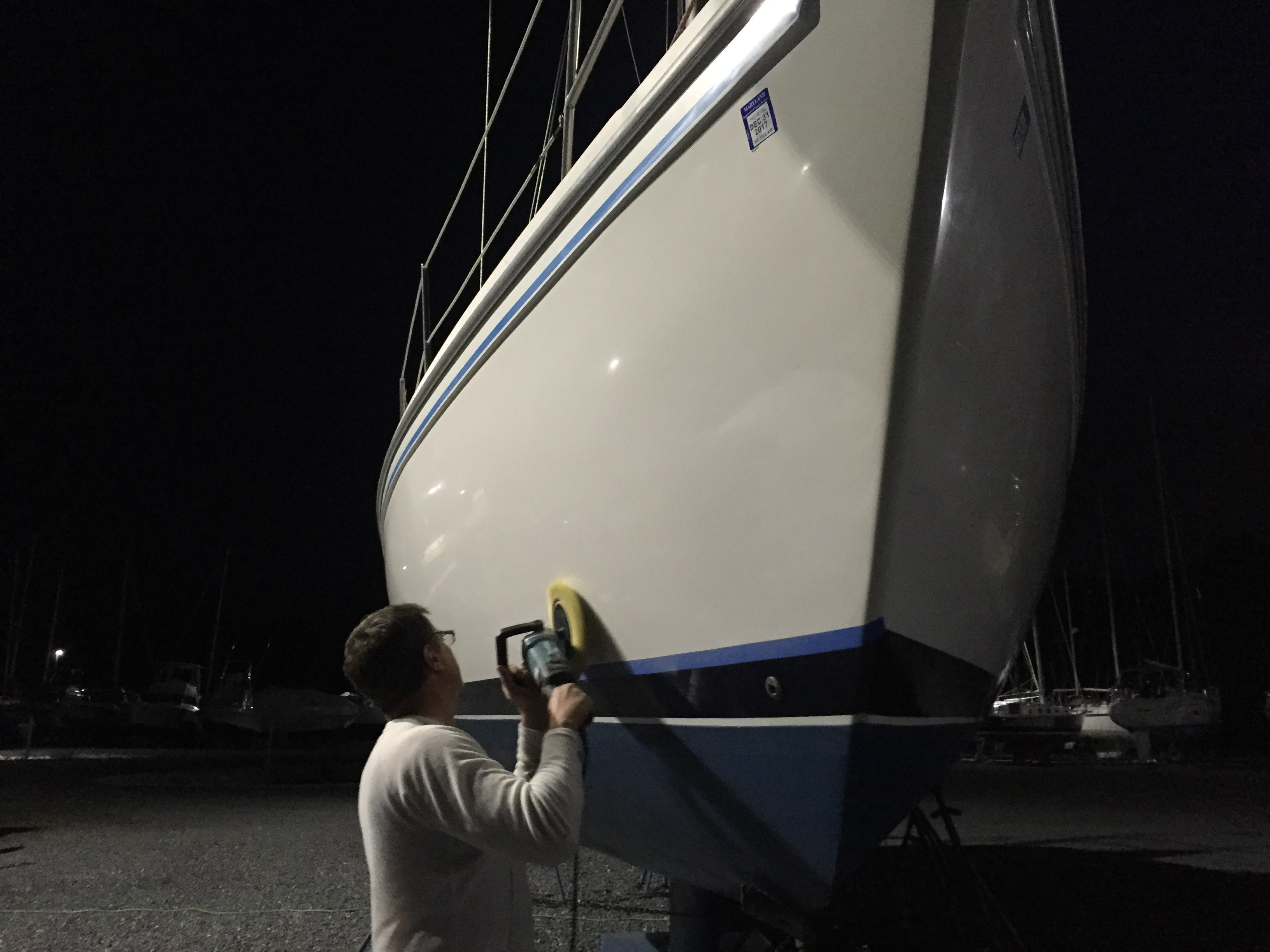

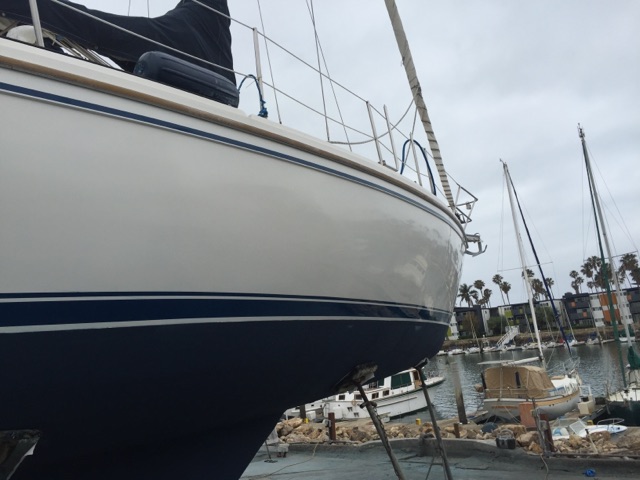

So I have the boat hauled right now, and reluctantly agreed to pay for a complete deep buff and wax (about $650).  I think it was worth it.  Just sent me some pics, and at least the boot stripe, but it looks like the other stripe as well, look like they have been pretty well restored.  I'm going to just need to stay on top of it.
