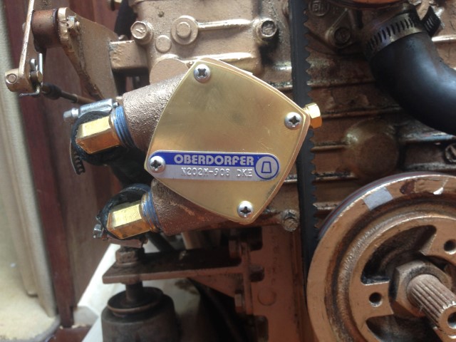

I'm replacing my pump with the Oberdorfer and I've found you can't screw in the two hose nipples as, if one is in, the nipple on the other hits the first as it turns. Anyone have an easy suggestion other than cutting down one nipple with a hack saw?
Chuck,
Cutting down one of the nipples is exactly what most people have done.  There is still plenty of room for the hose clamp to grip.
Posts: 616
Thanks Tom... I was hoping there was an easier solution. Looks like a really poor design. When I talked to the pump shop guys they didn't even seem to know this was a problem.
Chuck,
If one nipple is straight, and the other one is a 90* elbow, it's not a problem!  :-)

Bill... that's who I got it from....  neither the sales guy nor the tech services guy was helpful at all about this issue. The pump I got doesn't require the grinding of the flange that some had to do..... it's just that the nipples can't both be screwed in..... one has to be shortened
Chuck,
That is the case with all Oberdorfer pumps.  I should qualify.  Not ALL Oberdorfer pumps.  OUR Oberdorfer pumps.  The ports for the hose barbs/nipples are the same distance apart for all of the pumps that fit our Universal engines, so trimming one of the nipples is necessary.  But at least the pump you purchased does not require grinding down of the pump body, as many have done.

When I talked to DEPCO they urged me to order the 'kit' rather than the individual pump. I did. The Kit turned out comes with new right angle nipples and a solid 'L' bracket that holds the pump to the engine plus new screws. I installed the pump myself but dont recall having the same problem as yourself. I do recall the nipples had to be installed into the pump in unison in order that one would swing by the other.

When I replaced mine, the one nipple required just a minor grinding with a dremel. Couple of other suggestions- while you have the pump removed, check that there is a pump shaft sleeve in the engine block. There was an M35 recall because this part was omitted on some engines and it will increase the risk of shaft failure when it's not in place. Also, check that your new pump's weep hole is oriented so that any water leaking through the seal will drain through a low point in the pump housing and not into the engine. If the weep holes are nowhere near the bottom of the housing- you may want to consider carefully drilling a small hole.
