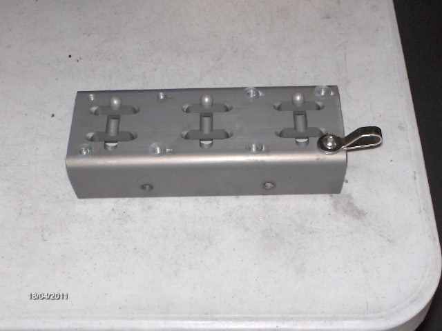

Thank you for the suggestion of calling Garhauer. What I learned was that this design is "obsolete" and that they no longer carry the part. What he suggested was "You can drill and tap for an eye as shown in the picture or attach the line to the eye that the mainsheet block is attached to." I can't imagine tying a line to an eye that looks like this or even drilling an tapping the traveler car. So, I will try to fashion something that is more like the original aluminum collar or have them made. I guess what make the most sense is to reinstall the original lines and wait for one to break.

That's the exact eye strap that is on my '97 traveler. I replaced my control lines last spring with no difficulty. The car is different, it has a single attachment for the mainsheet blocks; don't have a pic handy.
What Pat said. Did ours last summer and working fine so far. Usually saying that guarantees it will fail though, right?

Dear Bud and Pat
Thank you for providing me with a "duh" moment. A simple, non-elegant solution that should work. And, no money spent!
