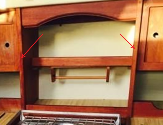

Has anyone ever removed the trim in the picture?  Does anyone know if it's screwed or nailed, or have advice the best way to get it off in one piece?  Thanks!

Can't answer your question directly, but I had an 1984 Catalina 30 and pretty much have found similar construction on my Cat 36. Look for screws. either covered with a wood bung or on a cleat from the inside. Although I had never seen a cabinet similar to yours and it could have been fabricated by a PO. So it could be glued and nailed. Good luck!

Thanks Gary.  There are small spots that were filled.  It looks like small nails.  I'm going to start with trying to gently prying them off.  Doing the counter tops will be a lot easier with those out of the way.

[quote=GaryB]Although I had never seen a cabinet similar to yours and it could have been fabricated by a PO. So it could be glued and nailed. Good luck![/quote]
I have the same cabinetry sans paper towel holder - so it is probably standard - at least on the first 100 or so boats built.

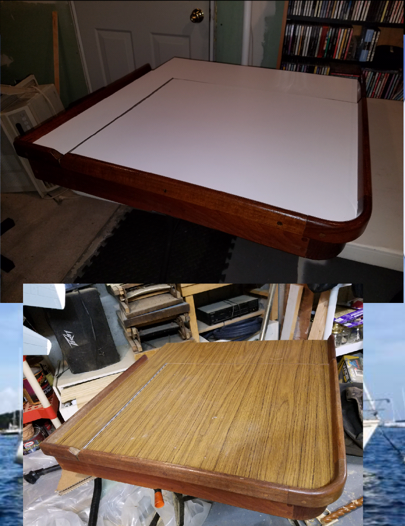

Would love to hear how you replaced the top on your nav station. Mine is original and has many unsightly holes from various mounted equipment through the years. Did you remove the trim fiddle boards?

I didn't replace the top, but put new Formica over the old. I did pull the fiddles and took the lid off.  I cleaned everything up, glued (contact cement) the Formica, routed the edges, oiled up the fiddles and put 7 coats of urethane, and put it all back together.  Really happy with the result.  The locker by the head is still dark brown, I'll do that in white as well, then the new granite-looking Formica in the galley with all the trim done as I did with the nav desk.

So, that trim was held on by staples.  I put a block of wood behind them and tapped with a hammer and they came off pretty easily.

Yes - great job - looks really good!  So the fiddles on the nav station (including the curved corner were nailed in place? I think I'll give that a shot this spring. I was terrified at the thought of breaking the fiddles and having to replace or patch them together. Did you consider stripping the old formica? Probably not worth the extra effort.

No.  The pieces that were stapled were in the galley running vertically behind the stove.  The fiddles (trim that's around the counter top, dinette table, chart table, 'game' table, etc., are all held in with screws that are located behind 3/8" wooden plugs.  They can be a little bit of a pain to remove, but not too bad with a little patience.  Once out you'll see the phillips screws behind them.  Mine were stuck a little beyond removing the screws and needed a little tapping from a rubber mallet.  Replacement plugs can be found on Amazon.  I think they're a few dollars for a bag of 20.   I did not consider trying to strip the old Formica.  I think that would have been a real pain and was not necessary.  The chart table was a fun project for this beginner and was done in a little over a week spending just a little time here and there during that time.  If you decide to do it and have more questions, feel free to ask.
