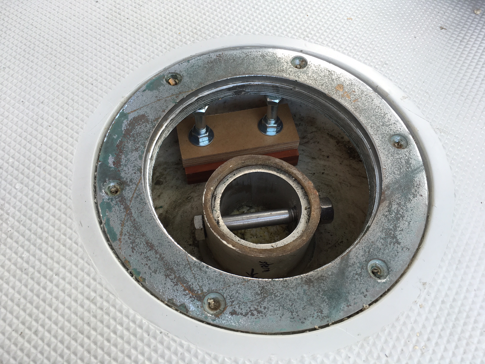

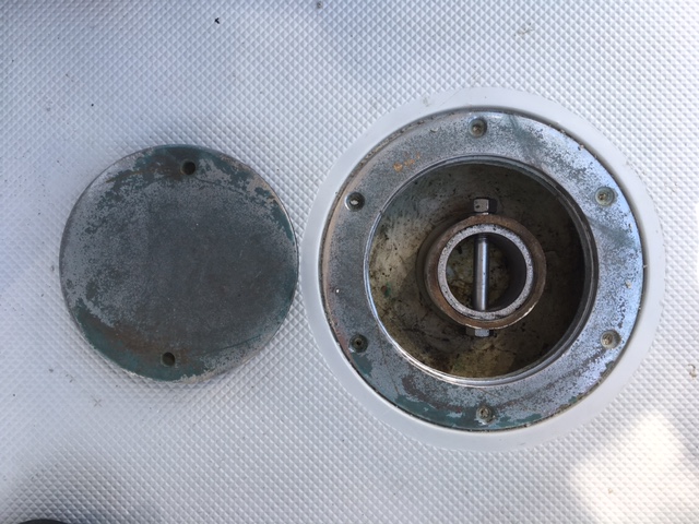

I am trying to remove our old bronze/chrome plated deck plate, because the chrome is coming off.  It is rather ugly and hot to step on. I have a new plastic deck plate that Catalina is  now using. Problem I am having is getting the out ring out without damaging the ring or boat. Catalina has pretty much glued the outer ring to the boat with the sealant. My only solution would destroy the outer ring by cutting through the ring and slowly peeling the split ring up.  I can get a pry bar under the whole ring now, but can not break the bond without risking damage to the deck.

Your previous owner must have put in the plastic plate. Catalina did not use plastic deck plates here until sometime after 2002. I used a heat gun as suggested and made a jack screw to push up on the plate as I heated the plate. I kept extending the bolt to push up on the plate. Not sure what Catalina used for chalking. I used Butyl tape on the new plate.
