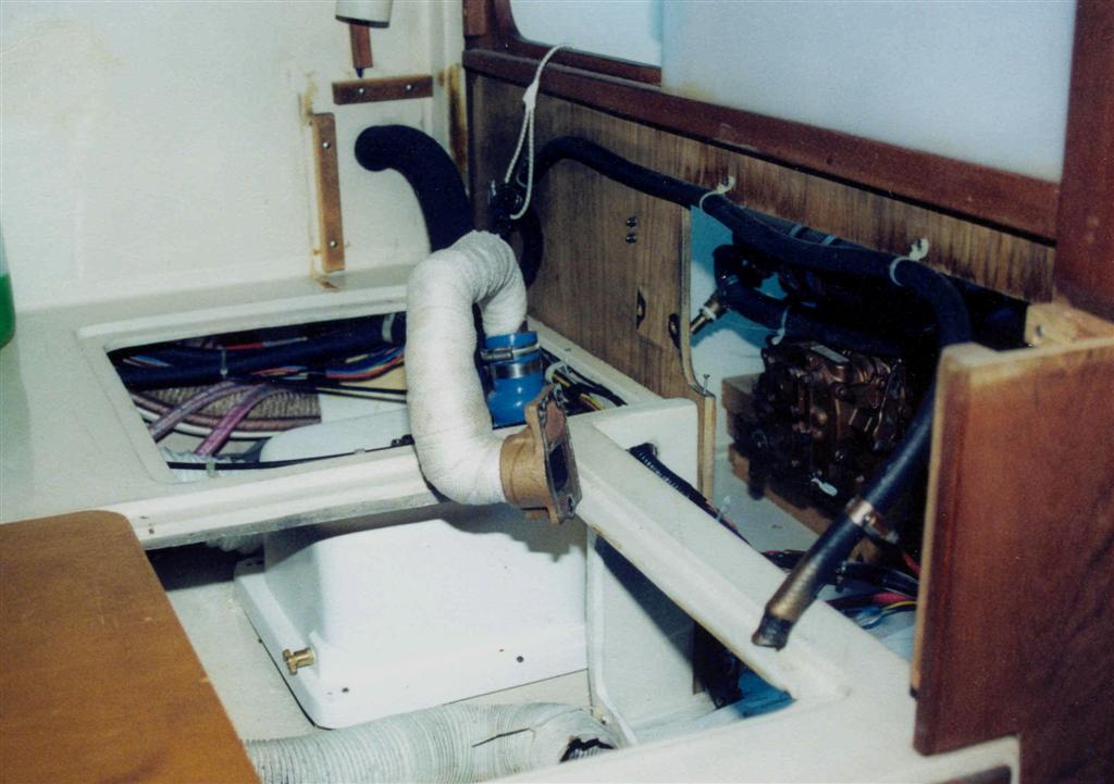

Let me expand on Steve's explanation. There are wooden "cleats" on both the inboard and outboard ends of the box. The cleats are fastened to the bulkheads, and the box is fastened to the cleats FROM THE INSIDE. The screws on the inboard end are not that hard to reach, but the ones on the outboard end are a PITA. You have to do it blind, but it can be done. You can get at the outboard cleats by reaching up next to the aqualift muffler, and you can get at the inboard cleats by reaching in from the main cabin. Whatever you do, please don't cut the box as I've seen done by several owners. It looks AWFUL afterwards. I've attached a pix showing the outboard cleats. Hope this helps.

Awesome!! thanks to all of you and Tom for the excellent photo..My boat is in top shape thanks to this forum!!
