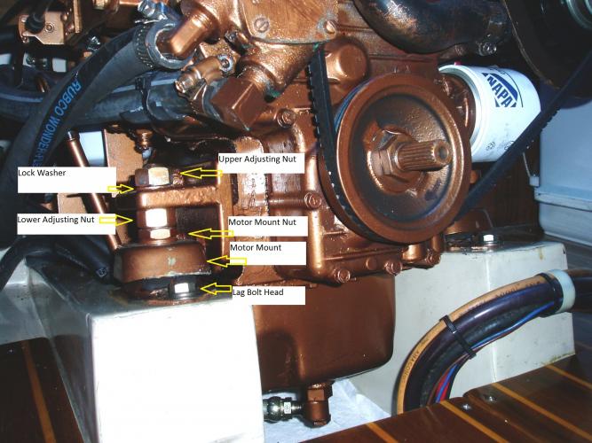

Abraham,
Perhaps this pic will help.  These are not OEM mounts, but the concept is the same.  These are softer Vetus K75's, so yours will not have the motor mount nut. Upper and lower adjusting nuts are tightened against each other, and with the lock washer, keep the engine in place.  This engine is just about at the lower limit of adjustment in the pic. Normally the nuts and engine flange are roughly in the middle of the stud.  Left/Right adjustment is done by moving the motor mount, after loosening the lag bolts.  Up/Down adjustment is done with the adjusting nuts. Hope this helps.

What Tom shows in the picture is exactly my setup.  One of my lag bolt heads was loose, so I tried to tighten it...but tighten it against what?  There is no lower lockwasher/nut that I can see, and by definition, a lag bolt would not have a lower nut, i.e. it's just basically a wood screw, and it feels like it's starting to strip out.
I think that over time, the engine vibration wears away the wood(?) into which the lag bolt screws, and this is what I'm thinking could cause excess vibration (on MK1s at least).
Rebedding the lag bolts seems like it would be a major job to fix.  Hopefully I'm missing something simple, coz this just seems like a poor design to me.

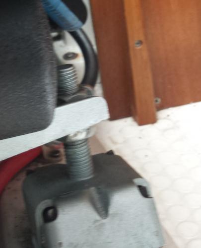

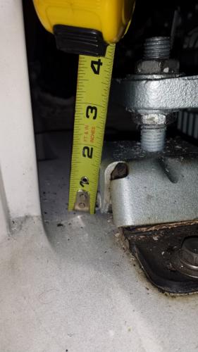

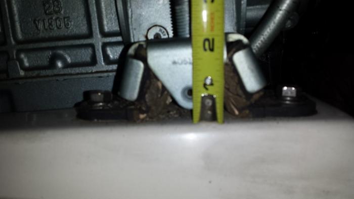

Motor mount issue?
I was able to take some pcitures of the mounts; since it is dificulry for me to know if a mount is in good service I was wondering if anyone here had an opinion:
First pic is the front starborad mount, notice the space between engine bed and tip of middle portion of the mount is a bit more than 3/8''
Second pic is the Aft starboard one, the same space is a bit less than 1/8''
Also, rubber in the aft one come above the metal part (see pcitures in next post), compared to front one.
Mounts in the port side are almost identica in spaces, look etc.
Thanks for any comments,

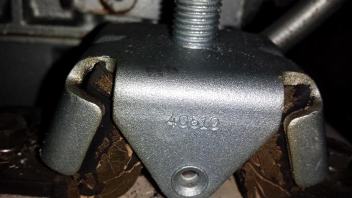

abaragones
Joined: 9/26/13
Posts: 32
2 other pics, sorry, not great angles/quality
fron mount (rubber below teh top of the metal)
Aft mount (rubber squashed, comming out over top of metal)
Sailing from Norwalk, CT
2002 C36 MKII, "Cataluna", Hull#2077
Peter Taylor's picture
Peter Taylor
Joined: 7/10/08
Posts: 107
Abraham
Can I just add to the advice from our fellow members and suggest that the engine mounts may be the problem as you suspect.
A while back, I ran over a mooring line which fouled the prop and stalled the engine. When I cleared the prop, and started the engine it ran extremely roughly to the point where I thought it would jump of the mounts!
Anyway when I got back to my slip there was no visible damage or change in the mounts. I had the boat checked out by a mechanic friend who said, from his inspection, that it was unlikely to be the mounts but more likely to be damage to one or all of the prop, strut, shaft or cutlass bearing.
Anway to cut a long story short, I ordered 4 new OEM Universal mounts from one of the Marine Parts Suppliers (Note: Listed in catalog as Isolators) and after installation and aligning the drive train, the motor now runs as smooth as silk at all revs.
abaragones
Joined: 9/26/13
Posts: 32
Thanks peter, I agreed. Annoyed that I would need to haul the boat to change the mounts but will see.
Thanks!

Abraham -
There is absolutely no need at all to haul the boat to redo the motor mounts. Replacing them was one of the first jobs I did on our boat when we bought her 4 years ago (per the surveyor's finding that they were shot); you just need to hoist up the engine a few inches to slip the new ones in. As I recall, the prop shaft and the exhaust riser needed to be disconnected (and the wood bulkhead removed), but nothing else. I raised the engine with a come-along and a bit of chain attached to a piece of 4x4 wood resting over the hatchway. Not a pleasant job, and some (interesting) contortions to get at some of the bolts, but not mechanically very complex. The worst part was repeated trips to the store to get more socket wrench extensions to get at some of the harder to reach bolts on the mounts (particularly the aft starboard one).
I replaced with the Vetus K75, as suggested by Soko. You should keep track of the existing height measurements, I used these as a starting point with the replacements before realigning the engine and found they were not far off.
Good luck!
abaragones
Joined: 9/26/13
Posts: 32
Thanks Matthew. I went ahead and changed the motor mounts with original ones (way overprices but for some stupifd reason I thought it would simplify the process). In any case the job was very easy, done in the water, and vibration and noise has been reduce by an enormous ammount. I am very happy with it. I will shoot a short video of the old mounts this evening and post it here, they look pretty bad to me.
Thanks!

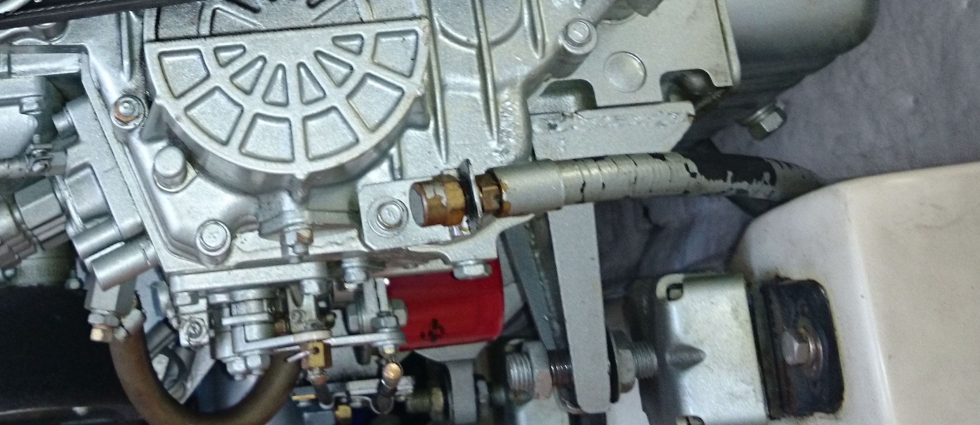

After ,  reading thru the post regarding the engine mount,  I want to attach this picture to ask if I need to tighten the nut on the top mount.  It is not tightened all the way to the mount!
Also,  Is it easy to adjust my idle from 600 to 800 so there is no rattling on start?
Please advise.

Jason, A few things. Please make sure that that nut is completely tight. Not sure why it is that way, the lose nut is probably making your engine jump all over the place, that is not normal (you need a 15/16 wrench). You could break stuff if leave it like that.
Regarding the RPM, as stated by the manual, your engine should be able to achieve 3000 RPM under load. There is something wrong in your case if you can only get it to 2400 RPM. These are my suggestions:
1. Check with a handheld tachometer that the RPM are correct (match the engine tachometer)

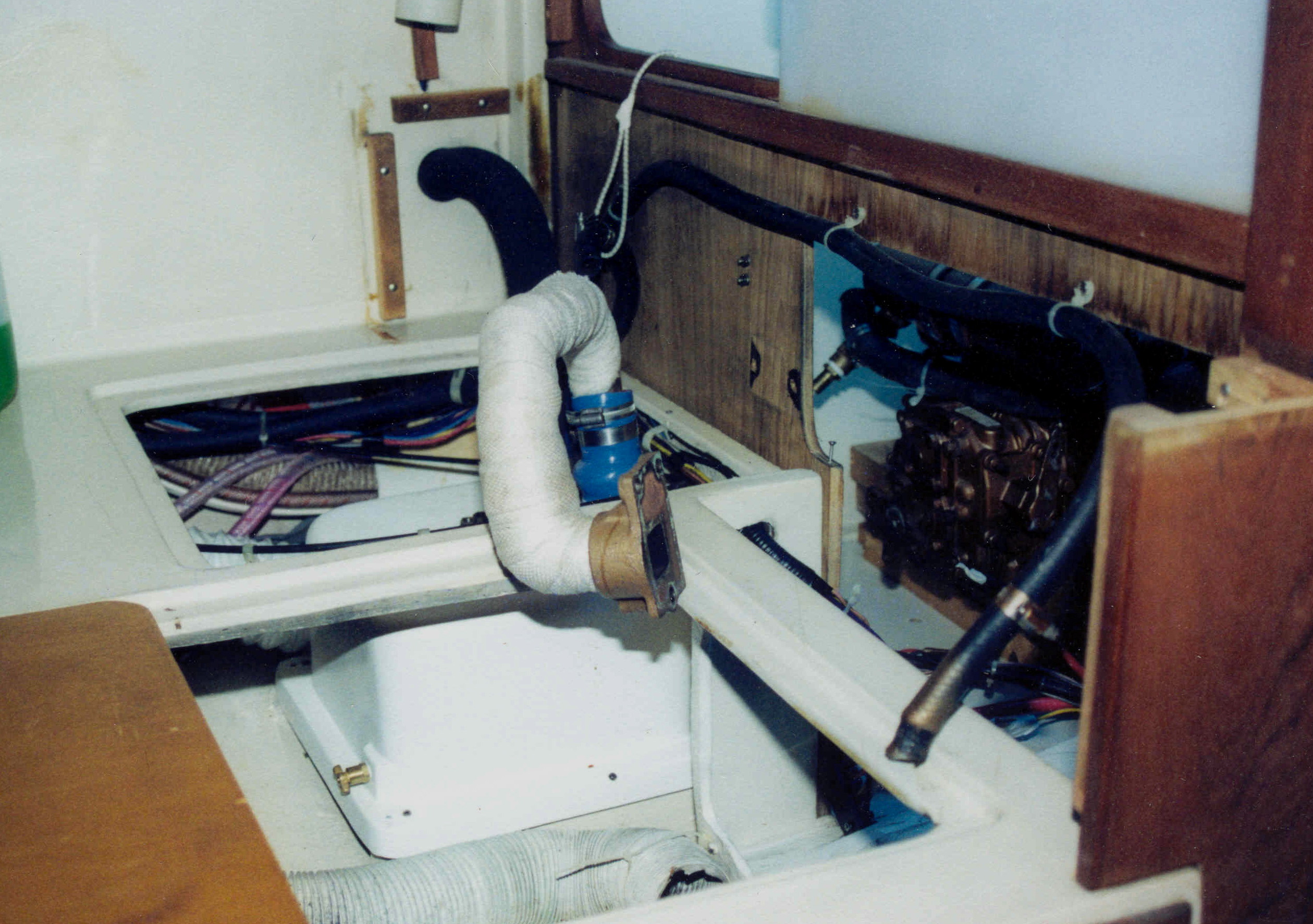

Andres,
Here's a pic of the blue hump hose (center of pic) recently installed in my 1987 MkI.  It might be slightly different in the MkII, but not much.  Hope this helps.
Image icon ExhaustRiser.jpg808.95 KB

Tom, Chuck
Thanks for the explanation and for the pic, I am still a newbie and many times a photo is worth a million words  :)
is the vibration reduced considerably?
have you also noticed the improvement?
BTW, how often do you replace the exhaust riser?
what sort of insulation do you have (sound/fire)?

Andres,
The blue silicone hump hose does not reduce the engine vibration.  It's purpose is to not transmit the engine's vibration to the aqualift muffler (and thus the hull), weakening and eventually breaking the large fiberglass hose nipples on the muffler.  I suppose that if less vibration is transmitted thru the hull, it might seem as if the engine is vibrating less, but that's just your senses deceiving you.
In the 18 years I owned Julandra, I only replaced the exhaust riser once.  The insulation on the underside of the aft cabin shelf was more of a reflective heat shield.  Other posts have mentioned that automotive exhaust wrap can be used to wrap the exhaust riser.  I have NO idea if you can find that in HK!!!  :-)  In the states you can go to just about any "Speed Shop" and get it.  Hope this helps.
