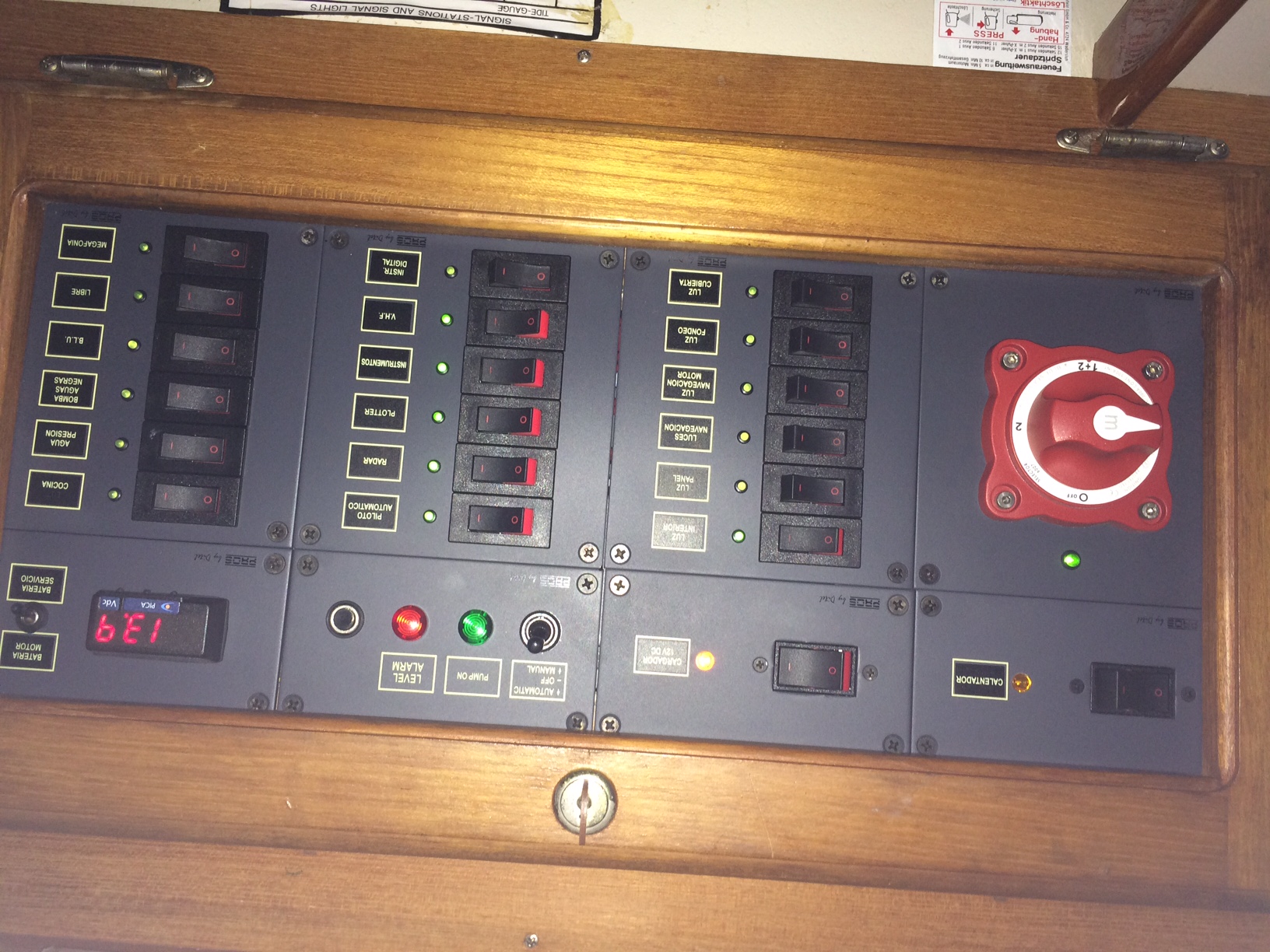

Hi,
In the almost 30 years Eureka has been with me, I had diferen brands, from original acid, Vetus (acid) Victron (agm) and recently Rolls (agm) without excitation, Rolls are by far the best of what I have used onboard. At least in Spain Rolls batteries have similar prices as other AGM brands -they are extensively used on solar panel installations- so better find a solar panel supplier.
In the Mediterranean the  boat is permanent in commission, with fridge electronics, etc...we have a 3 *120 ah as house bank and 1 110ah for the engine.
The electric switch board, allows to use the house bank to start the engine, if the engine battery fails and viceversa.
Just a thought
Eladio Vallina
C-36 TR EUREKA II
Hull 1122 (1991)
Home port Barcelona (Spain).
