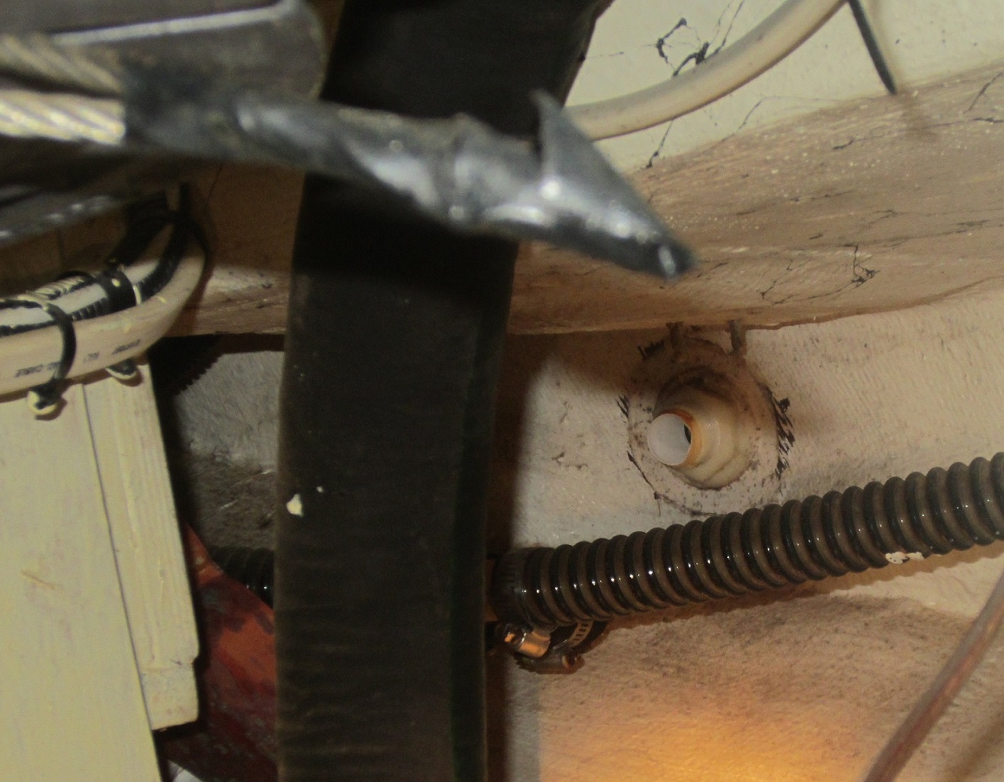

Two things:
1. Here are 2 pics showing the external location of the scupper drains on the transom, and the internal pic showing the broken drain fitting.

While installing my below decks autopilot we decided to check these out. It was noticed that my starboard through hull was already cracked off and just hanging there. That explains why I have water in some of the small recesses in the lazaretto. :)
Great heads up Duane. This is a really difficult spot to get to and one would not normally look there.
2000 C36 MKII 1825
Glad my post helped someone else. It is really a difficult area to see, let alone work in.
