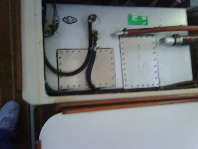

The tank on my '91 MK I is 33 gallons FWIW. When you have the new tank, you might think about cutting inspection plates on the top while the tank is empty. You'll need one on each side of the baffle. I had that done when I had my tank cleaned as well as a 1/4" hole with cap for a dipstick.
[ATTACH]1533[/ATTACH]
