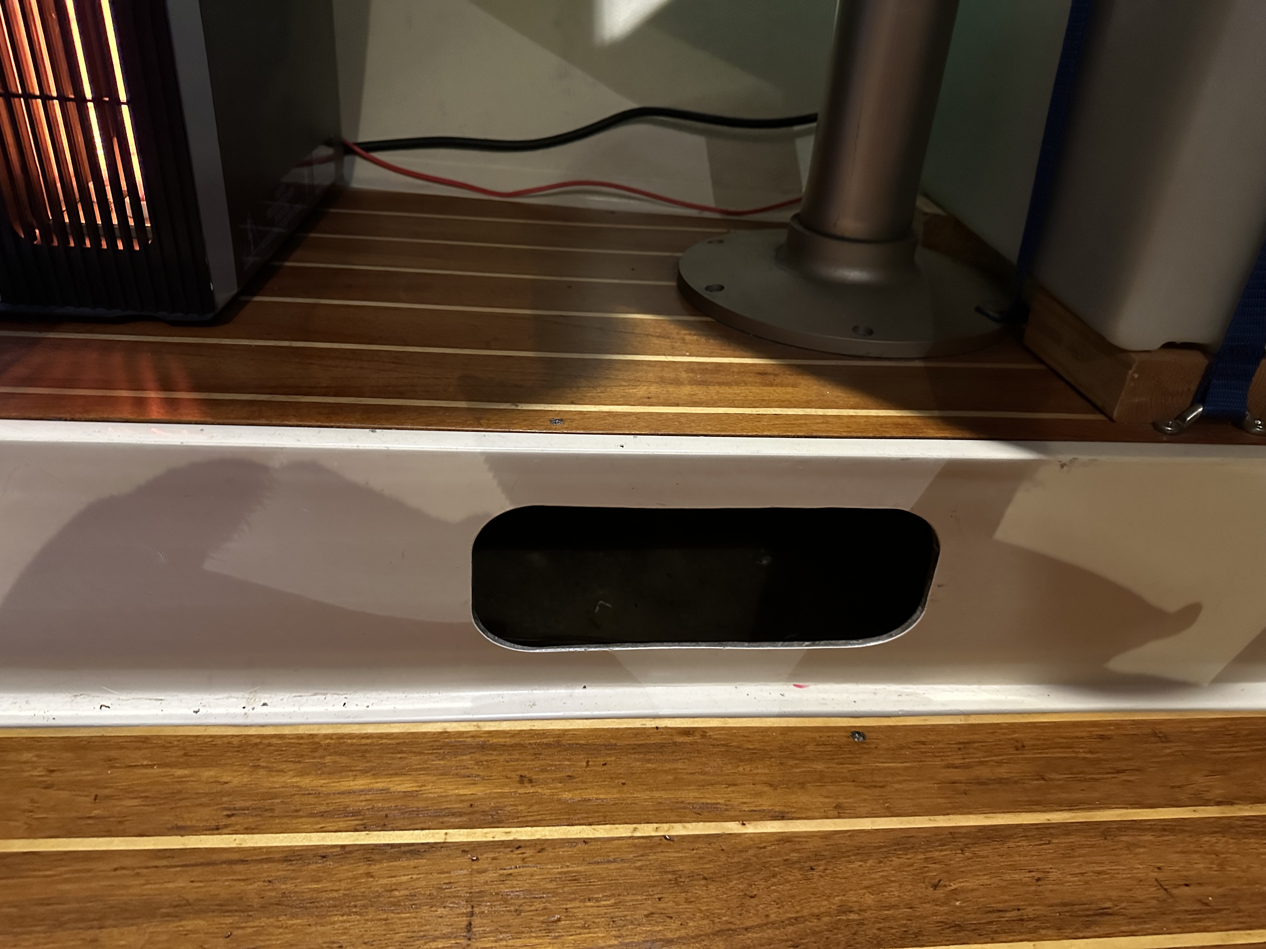

We recently purchased a 1989 C36 and one of the several to-do items is figuring out what hatch cover should be over the opening beneath the chart table shown in the photo.  I don't see anything on Catalina direct.  Any ideas what this cover might have looked like? Presumably I will have to fabricate something?  Any advice appreciated.

That is a custom access hole made by the PO.  Will require a custom cover.  I used that space (accessed via the bottom drawer on the forward side) to pile in a bunch of recycled lead to help fix our lean-to-port.  K.

Michael, We see that quite often as owners cut an access hole to tighten up the chair should the wood screws start to pull out. A good flat panel door is available from almost any marine supplier. You might have to modify to cut the cut out to accommodate the plate. Such as the
Bomar Inspection Hatch with Positive Twist Latch - G71030--WT
