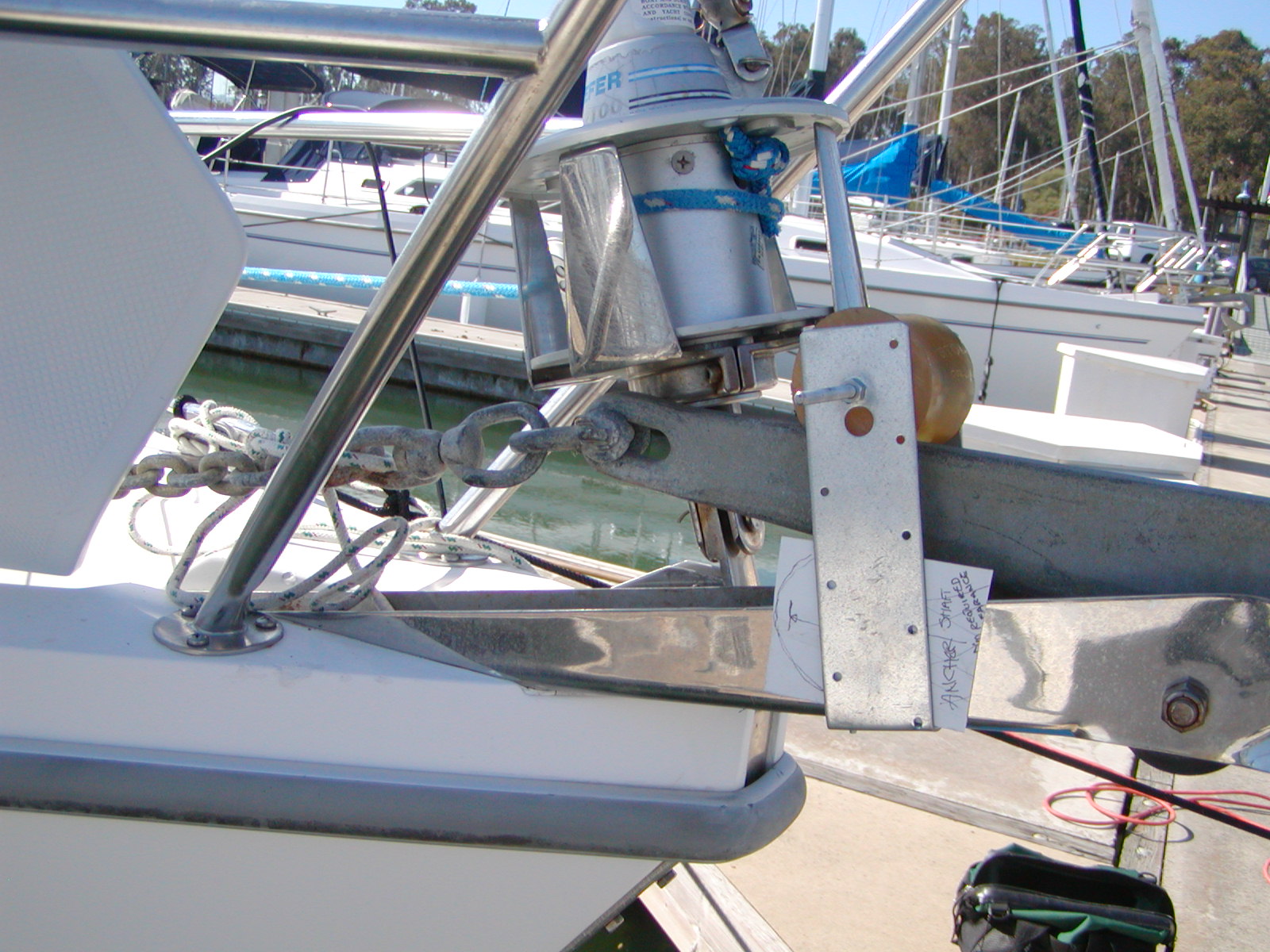

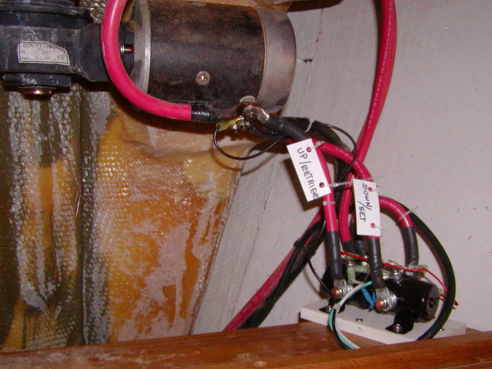

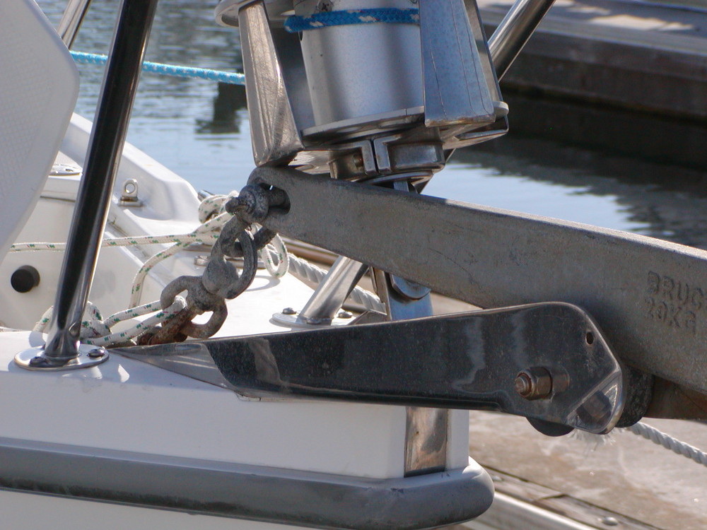

I added two relays inside the V-birth to forward and reverse the windlass motor and using a wired remote switch I can walk over to the bow or be in the cockpit and control the motor - a poor man's remote control. It does work well. However the other problem that I have is that when the anchor clears the anchor roller it rubs against the furler drum. It may damage the drum so I have to make hand adjustment and lay the anchor down. Do you have this problem? How do you handle this? Also I never use the windlass drum - how is this supposed to be used. I have the windlass manual - but it does not mention the use of this drum.
Nov 30-2013
I have added an Image (rightmost image) here of a bracket to the anchor roller to save the furler when raising the anchor. It works well. My anchor is 44lb Bruce. I have a video of it but it can not be uploaded to C36. Can the administrator add this module to Drupal? More later.

Haro, first, I cannot dream of having the windlass pull the anchor onto the roller. It will jam every time, but that may be because I have a larger than typical anchor (45 lb Delta).
Even pulling it up the last few feet by hand I have to go to some effort to get the shank past the drum.
When I had some rigging work done 9 years ago, the rigger didn't realize that there was a wire pendant raising the tack of the headsail a few feet. He said if he had known that, he would have recommended changing the furler toggle to raise the drum up to give more clearance for the anchor.
That may still be an option for those not using deck-sweeper sails.

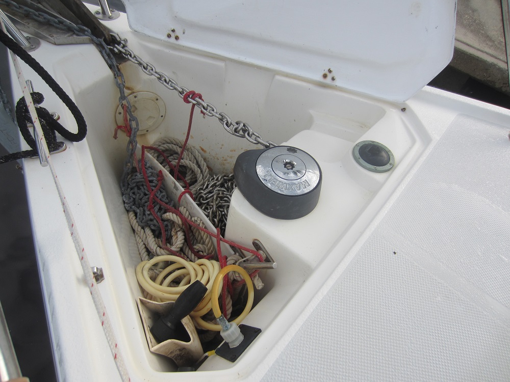

Here is the windlass as seen from above. I am sorry but I am not taking off the teak access panel in the V-berth to show it from below. It is a lot of work and the V-berth is currently not very accessible.
Hope this helps.
If it helps anyone - I have added 3 more images on my post number 6 above. It showes the panel before and after removal. I only had to remove 6 screws. The upper crown does not need to be removed. I removed it not knowing that it was not needed.

I posted a new photo on post number #6. Please view the bracket and the explanation. It works as intended.
I welcome any suggestions or improvements. By the way I am looking for someone that can bend the steel bracket for me. If you have a machine shop and can bend this 1/8" stainless steel bracket - I am looking for you.
