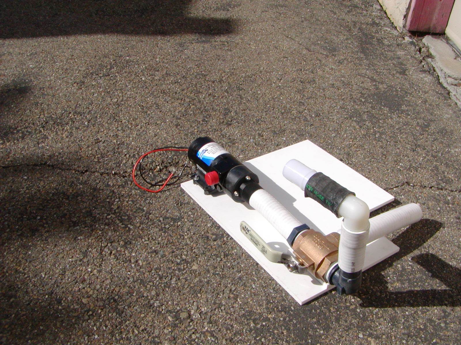

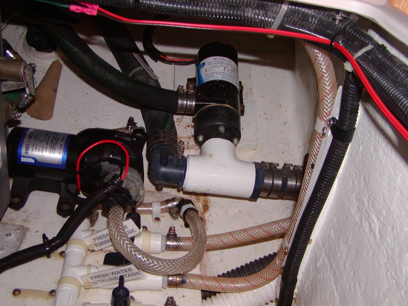

Here are some images from my project of replacing the pump. It was not as bad as it appears.
I have more images - if you would like to see them I can set-up a FTP site for you to download the images. One change I made on the new pump - was to rotate its 1" exit by 90 degrees. It helped to clear other hoses.
I would recommend to go to the pump-out then remove the holding tank hose so that if there is any more liquid that spills into the bilge - you can add water into the bilge and pump-out the bilge several times. You will eventually have to clean the bilge with Clorox and water.
