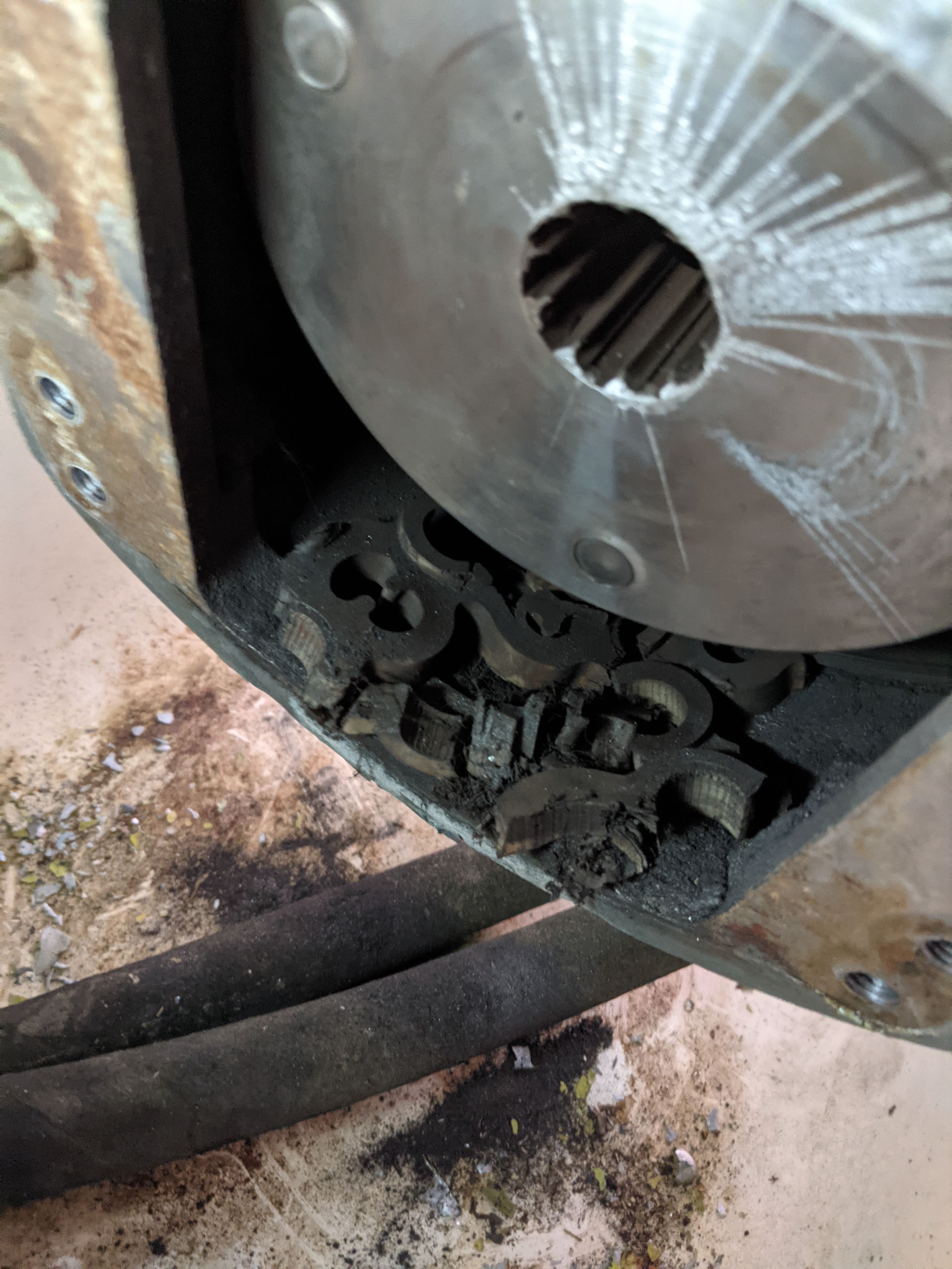

Here is a picture of what I found in the engine housing when I removed the transmission.
Pretty much all the dampening material in between the plates was gone (and on the bottom of the housing).  The plates were giving a very audible *clang!* while I was loosening the transmission.  Not good.  Hopefully the new plate will last me a good long time.
