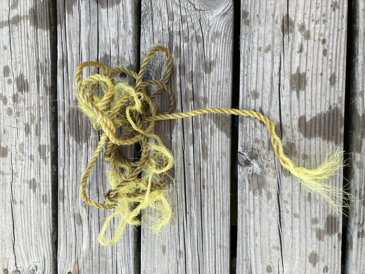

I had the same problem earlier this year.  It was a length of rope wrapped around the prop shaft.  Probably from a crab trap.   Before doing anything too crazy, bite the bullet and dive in to inspect the prop shaft.
