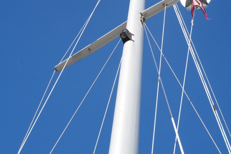

Here is a photo of what it looks like.
It appears that the new model is square and the model number is 8504.

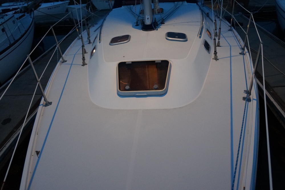

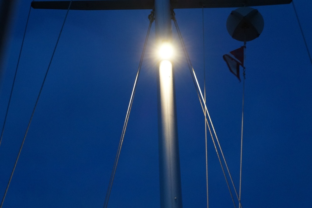

Here is what I found: You can puchase the LED replacement bulb from Home Depot for $6.97. It is 12VDC 20Watts, non-polarity sensitive. I also tested with engine running which increases the DC voltage to 14.6 Volts. All is good so far.
I have some images below and you can find complete images and write-up with receipts of the purchase and a PDF file regarding this fixture that is slightly too large to upload here, visit this site HERE

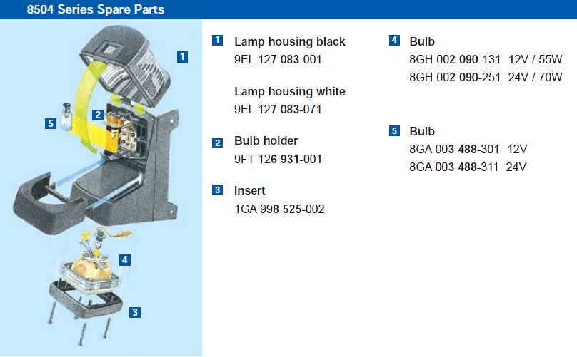

Please note - the break-out image shown here is 8504. It shows that you must remove 4 screws to replace the bulb. On 8505 - you only need a small screwdriver to open the hinged door. Please downlaod the PDF file and vew the details.
