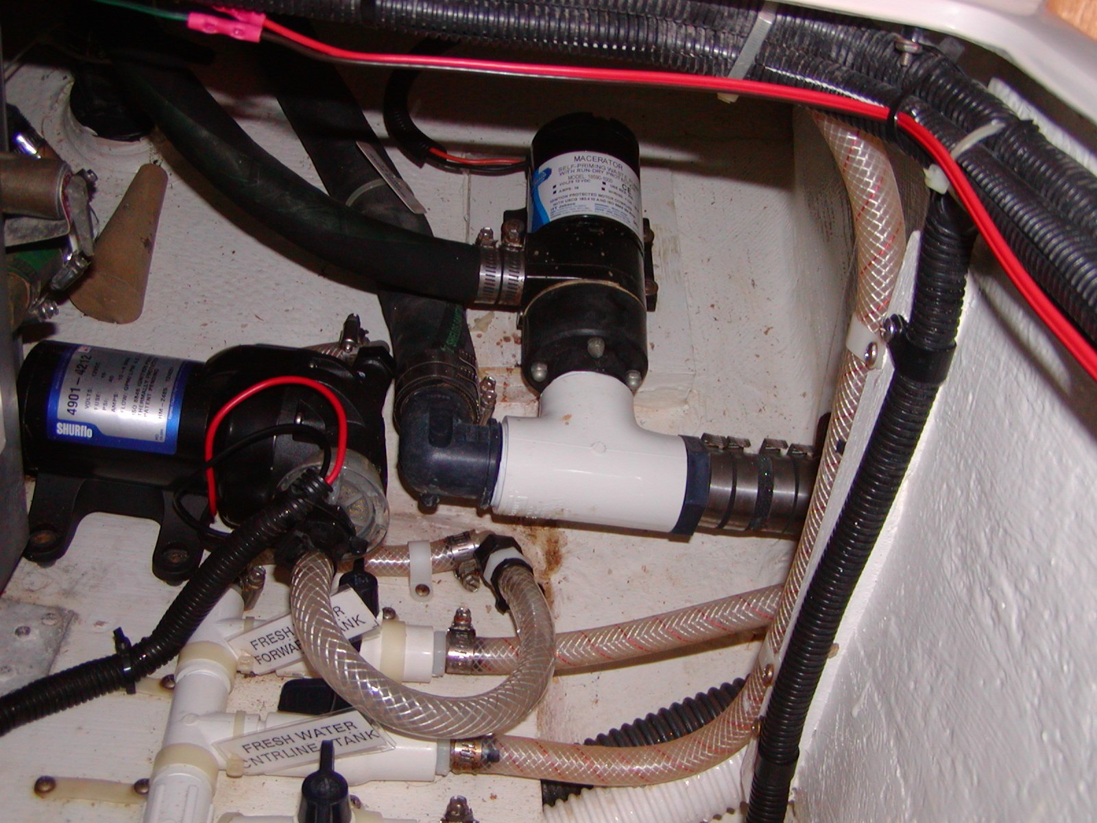

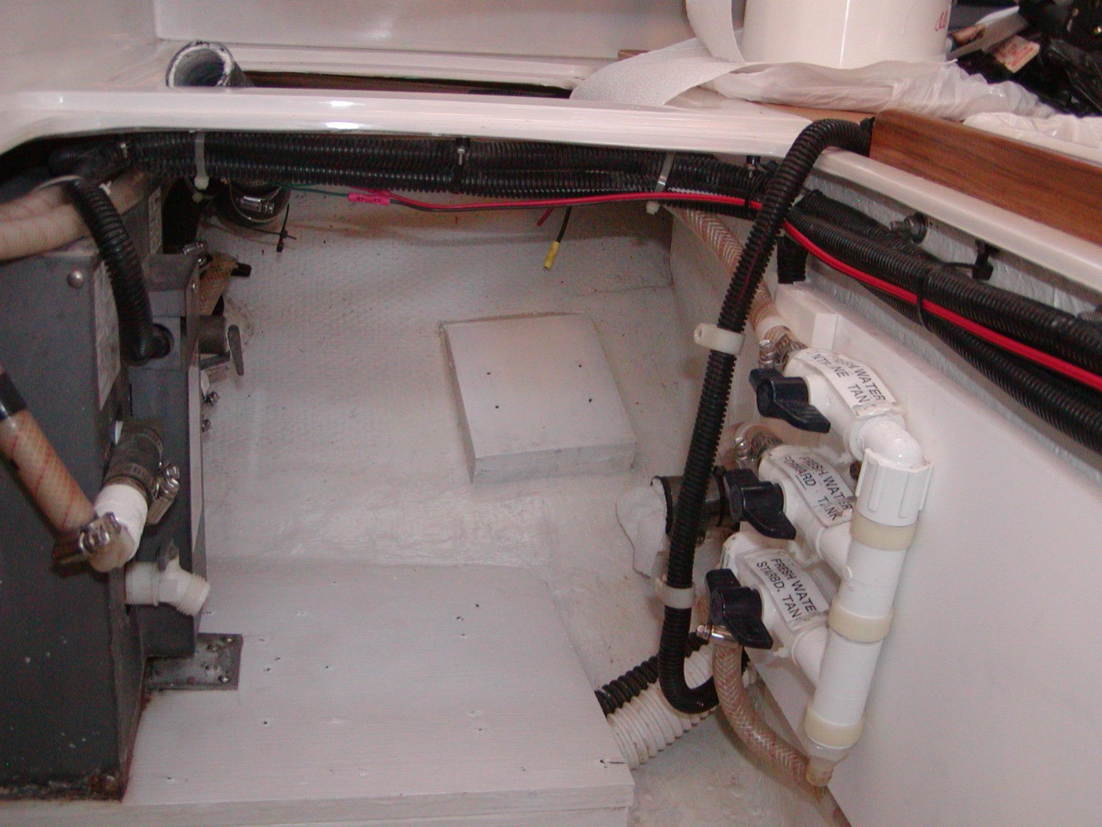

I am happy to say that I did not have to replace the tank - only everything after it. The macerator pump started to leak due to a broken pump screw. The unspeakable could not be stopped since there was no valve. So I added one and replaced the macerator pump. I discovered that the horizontal positioning of the output of the pump can be moved to a vertical position. The final product is clean and looks good. The valve closes both outputs when it is in the middle position. I also moved all the fresh tank valves and moved the fresh water pump and painted the area below it. I hope that helps to give you some ideas.

Looks good but one thing I didn't see was some way to lock the discharge line in the closed position. Do you have that? If not, you need it to be in compliance with regulations or you can get ticketed if you are boarded.(By locked, the regs say the valve locked closed, the head itself locked so no one can get in, etc.)
It may be as simple as taking the handle off and put it in a secure place away from the valve. The CG would be more interested in the the valve for the thru hull anyway.
Right out of my Vessel examiners manual for No Discharge Areas
Closing the seacock and padlocking, using a non-releasable wire tie, or removing the seacock handle.

Chuck - Yes there is a 1" discharge through hull that is not visible in the photos I posted. The discharge has a valve and is closed and tied with a tie wrap. That parts was already installed when I bought the boat.

Haro, that is a neat installation. It sure is nice having all the room with no A/C unit and the huge ducting that goes with it. Of course, in SWFL you can't give up your A/C.
