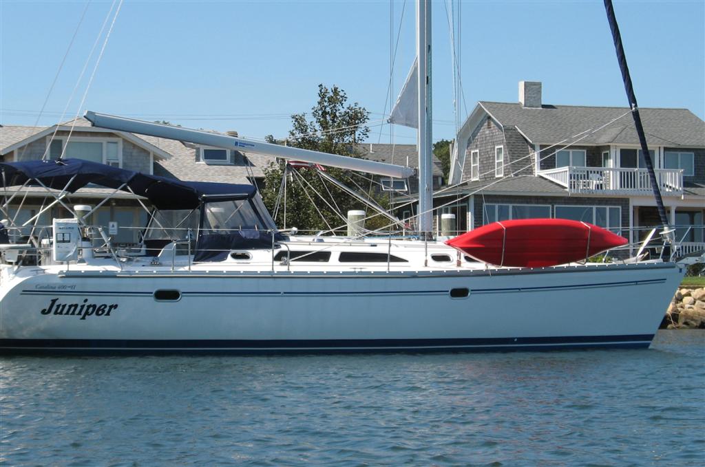

The kayak sits in the racks, and then a light line is tied from the top of each rack to the stanchion. The spacing of the stanchions and most kayaks puts the racks at roughly 30% and 70% of the kayak's length. It sits very snugly in the racks. I also take the bow line of the kayak and attach it to the bow pulpit for peace of mind. I've been through some pretty nasty stuff, and asided from bouncing up an inch or so, the kayak hasn't moved. I've attached a photo of the racks in use. Hope this helps.
Awright Tom, now you've done it. Posted a picture of your 400 on the forum. That'll get my wife going when she sees that, she absolutely covets a 400. So now I need to come up 100 reasons why we only need a 36. Help a bro out here and tell her how you really hate that great aft cabin she lusts after!!

I hate the boat....it's terrible....the C36 is a MUCH better boat. Does this help? :)

Nice set up, and boat.

What made you decide to mount kayak at the bow, versus mid ship?

Mounting the kayak between the first and second stanchion puts it "out of the way" for just about every task. Both the bow and midship cleats are still very accessible, and you can still come up to a dock on the side of the kayak without it getting in the way. If it were mounted midship (amidship?), it would obstruct the midship cleat, and hang out over the dock, broadening the beam by 18-20". I've seen lots of kayaks on boats, but I've never seen one mounted midship or aft. But then again, your boat, your choice! :)
